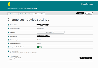

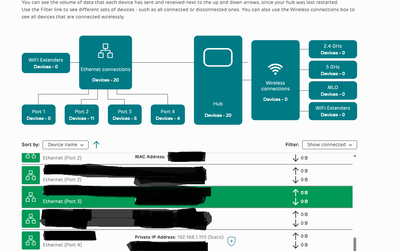

  1. I access the NAS drive via the web/google chrome, via the network definition on windows 11 for the NAS drive (MYCLOUDEX2ULTR2) and the WD App on my Smart devices. The IP address is 192.168.1.155
  2. The device has the Shield against it.  Plus has the FTP definition too.

3. The MAC address is accurate and matches the IP address

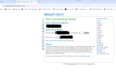

5. I have done a port check against 49592 and mysteriously it is open so why is port 21 not!  Confused.  Port 49592 was done automatically between the router and the NAS drive.
