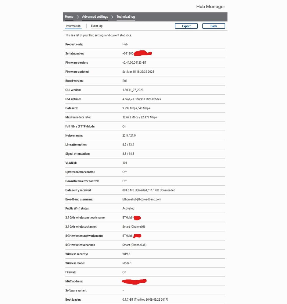

@superlubu5702 If you need from a BT Smarthub2 version which is virtually the same as you EE, little bit earlier in time wise but running on a 40/10Mb/s split no issue.
BT Smart Hub 2 from March 2025.BT Smart Hub 2 from March 2025.

@JimM11 : That 1's capped at 40/10 Meg. Hence the high NMs. Not what the OP should be aiming for at all.
