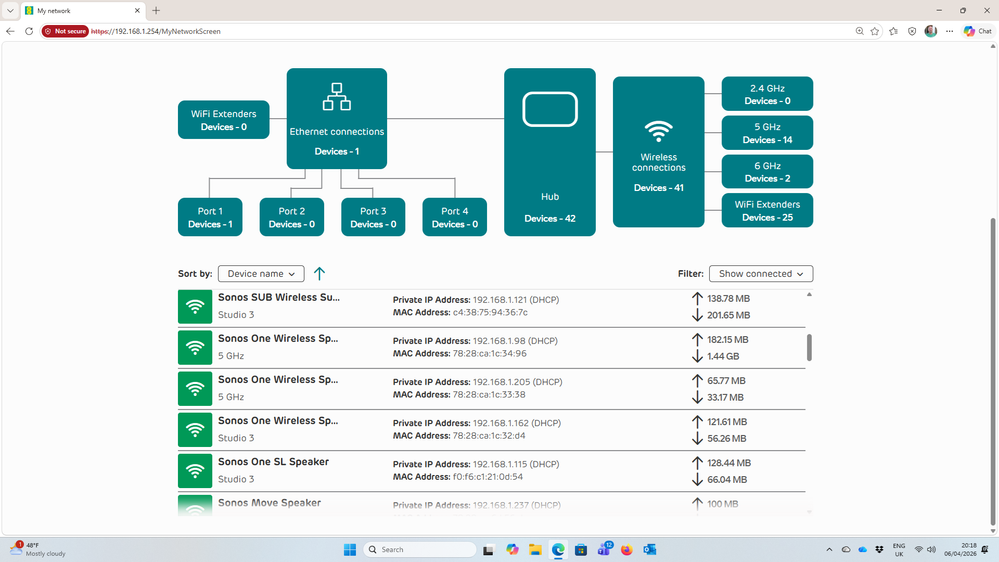

I'm not sure what you mean by a web capture, but attached is a screen shot of the main wifi connections screen:
I'll try and do a scrape of the network screen with the ip and mac addresses removed in another post.
Nowt is attached! Use the Camera icon above your text to upload an image file to here.
The image you had prepared but not posted is empty!

Anyway, I have now managed to do the screenshot and attach it, but I can't remove the IP addresses, but I've got the hub's firewall on so I figure it can't do
any harm.
Adrian.My Wifi network
