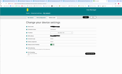

SamyM
Established Contributor
Hi,  The is the address table for 192.168.1.155 which is my cloud.  The IP address is Static.
 I cannot find anything wrong.
Samy

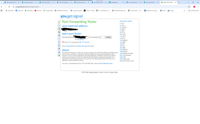

SamyM
Hi, Checked the port and shows
Samy

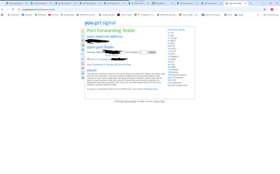

SamyM
Hi,
The port is closed still
bobpullen
Star Contributor
Star Contributor
Slight tangent but this clearly shows that it is your NAS that it automatically opening up that 49592 TCP port using UPnP. Why is it doing this? What access is your NAS expecting to be made over this port? If you try the yougetsignal check on this port, is it open? - That would at least prove that traffic can get to your NAS via a port forwarding rule.
Whilst it really shouldn't be necessary, I still think it's worthwhile you temporarily disabling UPnP in the hub and rebooting it to see if it has any impact.
Can you access the NAS locally over FTP when the 7 Plus is in situ? i.e. by FTP'ing directly to the 192.168.1.155 address? If you can't, then something else is awry as a connection over your LAN has no dependency on port forwarding at all.
A very unlikely angle but do you have the Advanced Web Protect feature enabled in the EE App? Might be worth checking that to make sure the inbound attempts to access your NAS aren't being blocked.
