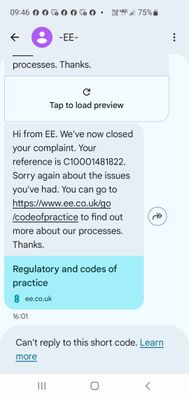

Hi, I phoned EE and we went through connecting Hub 7 Plus going through the app to setup the device. It then gave me the option for the advanced web protection. So I disabled it with EE on the phone line and then did some testing for port forwarding. She talked me through what to do and port forwarding did not work. Tested the port and still closed. She then said she has not worked withe the RE Hub 7 plus before and she raised it withe her supervisor and then they agreed to raise a complaint and said they would call back when there was a resolution. After ending the call 30mins ish later I got a message that my complaint has been closed. This is what happens each time.
Samy

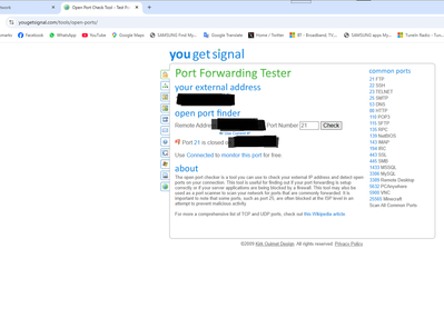

As not using ddns how are you ensuring your external domain is pointing to the hubs external ip address? When you run the port open checker, have you double checked it shows the current hub external ip?
I just do not understand the end to end config. It makes no sense that port 21 is open when enabling dmz, but not when using port forwarding.

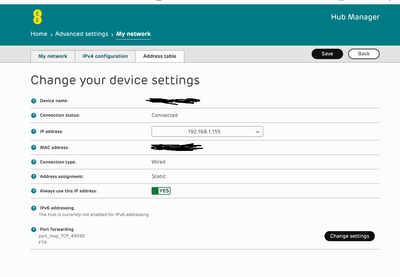

3. The MAC address is accurate and matches the IP address

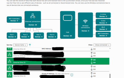

4.I have plugged the NAS drive direct into the EE Hub 7 Plus and no change
5. I have done a port check against 49592 and mysteriously it is open so why is port 21 not! Confused. Port 49592 was done automatically between the router and the NAS drive.
6. I have tried disabling UPnP and no difference. Port is still closed.
