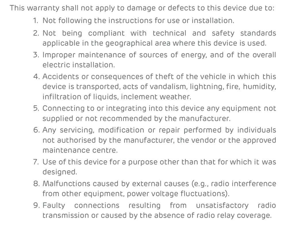

Please note however, that whatever you use is an addition to the EE device and therefore, if you have any issues with it, then it will potentially not be covered under your EE warranty which lasts for 24 months.
