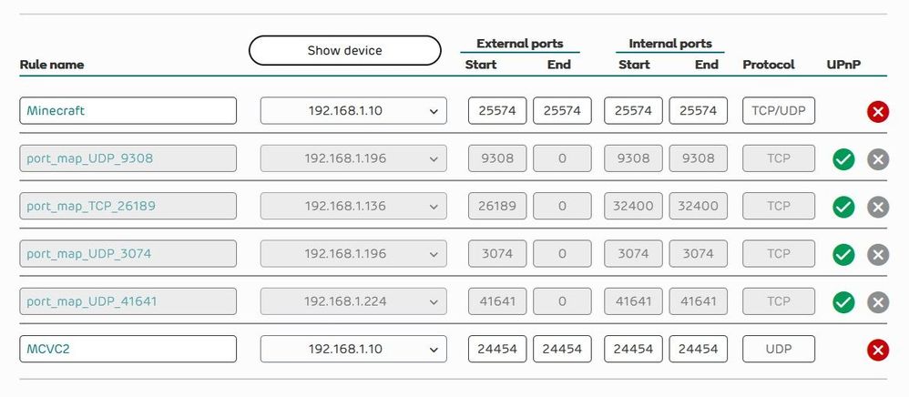

@IIIIIIIIIIIIIII You need to post a capture up first off your Port forwarding rules, in the meantime there is just plenty on the Forum regarding the why/why not the Pro is just not playing ball now.  The link below will get you started.

Thanks. Hopefully this helps. Will have a look at the link you posted
@IIIIIIIIIIIIIII Will check once your picture get's cleared for general viewing, remember to use the link within the other post as well, hopefully there is no need to go down the Factory reset for your 7 Pro hub, more an issue now with the uPnP that was introduced with the latest FW up dates that EE have applied, bit off a follow on from the 7 Plus bug that was NEVER in the Pro version but is possibly now.

On reading various posts I noticed something was said about port ranges being zero. Not sure if this highlights an issue however there's 3 devices port forwarding that the end for the external ports are zero. The internal start/end match with the start for the external but the end just for the external is zero. These are also greyed out.
Might be nothing but thought I'd mention it
Try disabling uPnP in the Firewall to get rid of those 4 faulty auto uPnP rules. May need a reboot.
@IIIIIIIIIIIIIII Picture cleared and if it is the uPnP causing the issue then the one you have is port 26189 on the machine with the IP ending 136. Only suggestion is turn those 3 systems off, and see if the uPnP disappears from view, or is stuck there forever.
How do you work out that it's that particular rule out of all 4 rules that is behind the issue?
