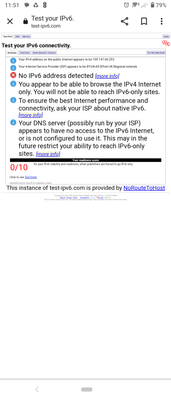

I have my Xbox series X hard wired and Xbox series s wireless smart wife plus up stairs,I've tested ipv6 on Sony Xperia 1 and new iPhone and already done a system reboot, this is wot it shows in the hub

This is the ipv6 test site

I can't see the second image as I suspect it might contain identifiable information so hasn't yet been approved. Looking at the first image though, it suggests to me that the hub itself isn't getting a public IPv6 address assignment; all the IPv6 addresses are local. I wouldn't expect this to get good results on the IPv6 test site?
I have just checked an Xbox Series S that I have wired to my SH+ via a couple of unmanaged switches and it looks to have full IPv6 connectivity. Moderate NAT (I have UPnP disabled and no port forwarding), but it's getting an IPv6 address 🤔
@bobpullen : The OP's 2nd image showed her public IPv4 IP & stated that no IPv6 IP was found. She should re-post it obscuring her  public IPv4 IP.

The OP's 2nd image showed her public IPv4 IP & stated that no IPv6 IP was found...
Thanks, that's all the info needed really so no need to re-post 👍
