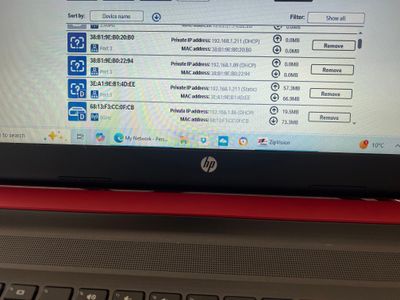

they then wanted to view them online from the phone. So set the equipment to be dhcp enabled and take their ip addresses from the router. The DVR seems to remain as a static ip address, but the cameras keep changing. I keep having to go back and set the camera ip address in the DVR for it to reconnect.
I have accessed the router settings and when you find the equipment in the list you can set it to use this ip address, then when saved says (static) next to it.
then after a few weeks it goes offline, I go back check DVR, and the ip addresses in the camera list have changed, I need to remove the 2 old ones then re add the new ones, normally drifted by 1 digit up. Check router again and the old ip addresses have gone, and new ones in the list not static.

Done all that but the static ip address doesn’t stay static. It changes. So I need to keep going back and putting the new ip address into the DVR.
Also noticed on last trip it wouldn’t let me set a new static IP as it said it was in use. Looking through the list, the ip address was in twice by 2 different items!!

logged into router and there is a camera ip address assigned to 2 MAC addresses, how does that happen.

@Andy2315 Do the cameras per chance have wireless and also an Ethernet port, if so then not unusual for the camera to have a mac for each port, and if so sounds like the EE Router has managed to find out that there are two. If not then the DHCP on the router has really got messed up with it's internal memory when it stores the last assigned IP/Mac when request for IP is made from the camera's.
Hi, just standard ip cameras, no WiFi option.
He went wired for cost and reliability. But his router must be well and truly confused.
Hopefully turning off the cameras dhcp and setting them on their own address will be the end of it. So much for the use the same address toggle!!
