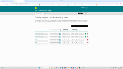

Hi,  I've taken some screen shots of the Hub 2 manager firewall and the Hub 7 Plus manager firewall.  Switching back to the Hub 7 Plus it's so slow and clunky and it produces error messages when things seem to time out.  EE that was such a bad decision with the Hub 7.  Back to the screen shots.  I’ve tried playing with all sorts of setting and nothing seems to work unless DMZ is enabled.

 This next screen is from Hub 7 Plus and this does not work at all.
Any clues as to why the EE Hub 7 Plus does not work?

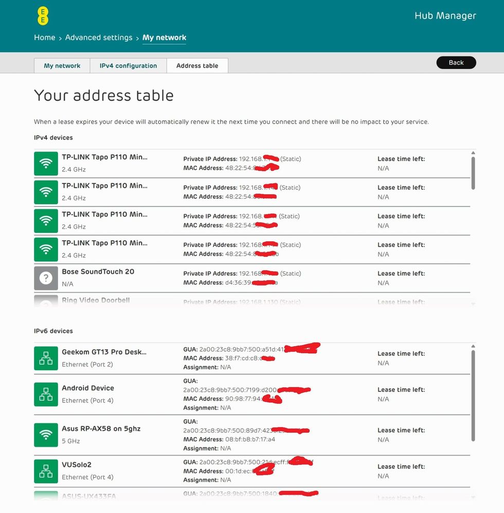

@SamyM Cannot comment on the web Manager Interface to the new EE Smart Hub 7 Plus version you need someone who is using to see what the response is like with it, on the Ethernet side off things is the unit getting the same IP from the DHCP of both the BT/EE hubs, and you know that for sure, have you tried to go set it so it is Fixed ip as always in the EE Hub that appears to be 192.168.1.155 on the Hub2 posted picture. Think i have a sample for the old 6 plus as a picture will go look and see. Although the edited picture is showing wireless devices, all wireless/wired are set as static IP's in the control.
Set as static for ALL devices.Set as static for ALL devices.

@SamyM - if you click that 'Show IP address' button on the 7 Plus screen, what IP is associated with the port forwarding rule? Does it definitely match the IP assigned to the target device/WD in the list of network devices as shared by @JimM11?
On the 7 Plus, you have some UPnP rules that have a '0' end port which looks a little unusual. Unsure if this could cause any problems but it might be worth finding out the device that's creating those rules and temporarily remove it from your network. Alternatively, you could try disabling UPnP in the Advanced Firewall settings to see if it has any positive impact. You shouldn't need to do this, but I'm fast running out of ideas.

Hi, Not sure where these definitions come from, but when I do a reset of the router Hub 7 Plus they appear automatically, It’s the router creating them not me.  I’m doing the FTP and the http.  The others seem to be created when I reset the hub.  The IP address for the FTP and http I know match the WD EX2 IP address.  The other 2 wasn't sure about them so thought leave them alone.  Didn't check the others.  What do you think?  Try and delete them and see if that resolves the issue?

I imagine those are empheral ports created by UpNP from somedevice on your network. Do you know which app/device is creating them? Turning UpNP off would stop them being generated,  but I can't see how that impacts your port forwarding issue. As I my previous post from a while back, I had similar port forwarding issues with 80 and 443, that I eventually resolved by factory reset and starting over. You appear to have done that several times, and still can't see port 25 fron the Internet. Assuming you domain is pointing at your network external address correctly,  and it all works on old hub, I'm at a loss

Hmm, assume upnp is on for hub 2? I don't get any "phantom" forwarding rules on my hub 7. Very odd
What happens if you turn of upnp and reboot, are they still there?

I cant see from the screenshot but do the mystery port forwarding rules not show the ip address of the originating device.?
