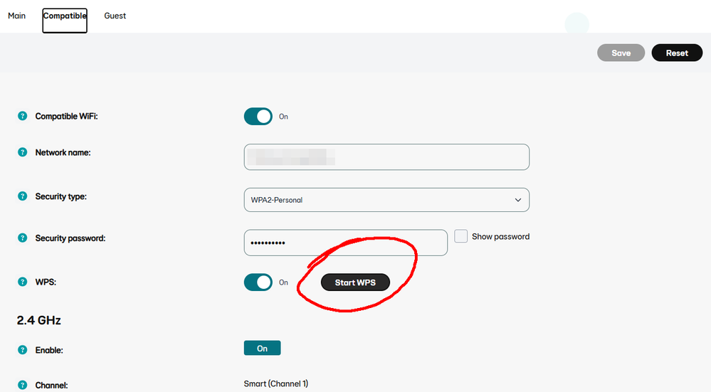

3) With WPA2 settings I was able to get the robot vacs to work, and I did not need to turn off the 5GHz frequency (the robots work on 2.4 GHz)  BUT neither my Wifi extenders nor my printer would pair using with WPS, I had to use the password route and re-enter the  mandatory 12 character password.
@OldNumber1 - how did you initiate WPS? The physical button on the router will only ever trigger WPS for the main WiFi network, not the Compatible WiFi network.
If you want to initiate a WPS event for the Compatible WiFi network then you need to do that using the software button in the Hub Manager on the Compatible WiFi settings page (below is from the new look Hub manager which you may not have yet but you get the picture): -
I tried that when the WPS button on the side of the router did not cause the status light to flash.  It did not seem to make any difference and I may have lost the will to live....
I repeat, none of this is in the guides supplied with the router or the on-line help.  The Community is useful, but if you don't know a Compatible Mode exists, why would you ask about it, let alone ask about what to do if the WPS button on the outside of the router doesn't cause the status light to flash.
