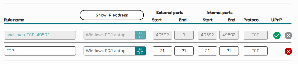

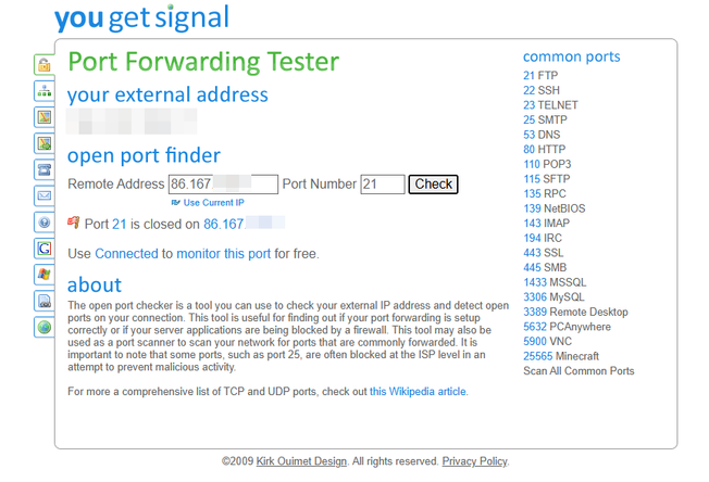

 I then created an FTP rule via the Hub Manager and spun up the same FTP server I used previously (where I was previously unable to replicate the problem): -
And lo and behold when checking the FTP port, it's closed! Exactly the same as what @SamyM  is seeing: -

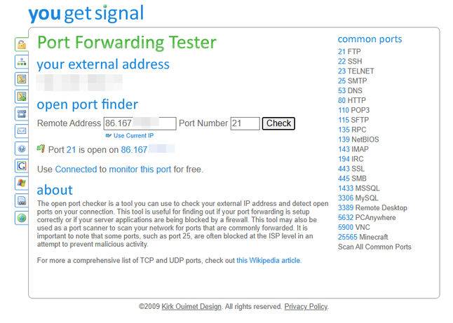

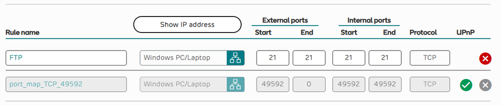

And for the somewhat interesting bit. If I factory reset my hub and try  again, but with the rules created the other way round: -
I check the FTP port and it's open again!

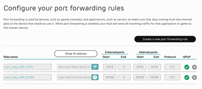

I've been toiling with this for the past day or so - I changed the IP address of my webserver and couldn't edit in the UI - gave me some odd errors about ports overlapping.
I deleted and recreated the https rule but although it successfully saved the rule, traffic  wasn't being directed to the web servers.
I had these two UPNP rules which I couldn't remove using the UI and several forum posts suggested that this could be the cause:
I didn't want to factory reset the router so I tried using miniupnpc and I was able to delete both rules and then succesfully re-add the https rule for my webserver. Traffic was then successfully directed.
The commands to delete were:
upnpc -d 3074 TCP
upnpc -d 3074 UDP
upnpc -d 53199 TCP
upnpc -d 53199 UDP
I tried both TCP and UDP - the rules show as TCP on the UI
