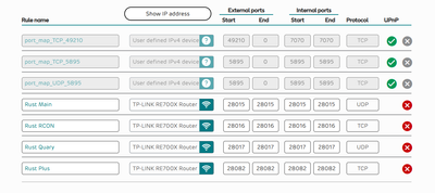

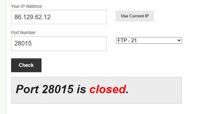

LiamStevo_0-1780496155855.pngLiamStevo_1-1780496165151.pngLiamStevo_2-1780496181849.png
Hi everyone, I’m still having trouble getting any game ports (like Rust, Minecraft, etc.) to forward on my EE Smart Hub 7 Plus. I’ve restarted the router, done a full reset, disabled DHCP on the extender, and set a static IP for my PC. I followed the EE guide step-by-step, but it still won’t work. Also, I keep getting sent the same port forwarding guide link, even though I’ve done all the steps. On top of that, there seems to be a glitch on the EE site: when I try to manually set the IP under user-defined IPv4, it just shows red boxes, and I can’t set external ports—only internal. Has anyone else run into this, or have any other ideas? Thanks!

Why are you selecting the IP off the RE, should be the PC or Server....

i put the IPV4 FROM CMD ipconfig

I'm pretty sure that it is not the TP-Link Router that is providing the Rust service.
