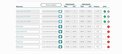

@LiamStevo wrote:
@LiamStevo - you have UPnP rules above the ones you're trying to manually add. Whilst this shouldn't have any bearing on things, a bug was spotted a while back where its found to break things.
See here.

So Do i need to remvoe it or reset coz of those ports as i can remove them
03-06-2026 09:53 PM
so what should i do and do i need to remove these also how as the remove is blocked
03-06-2026 10:02 PM
You could switch uPnP OFF under the Firewall.

But im going to have to connect a laptop to set it up again is that ok also is it the UPnP casuingv the bugs should i leave it off
