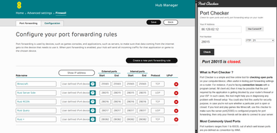

I've been trying to open specific ports on my EE Smart Hub, using a TP-Link RE700X range extender. My setup is identical to my previous router, but now the ports won't open. I’ve manually configured them in the EE Hub and in Windows Firewall, set up a static IP for the extender, disabled DMZ, and tried full resets. EE support was unhelpful—they just suggested restarting the router and re-following the guide, but nothing worked. Has anyone had this issue or found a fix on EE?

The important thing is that you don't have any manual rules underneath the UPnP ones in the Hub manager table. If there are UPnP rules at the bottom then things seem to work OK from what I can tell.

So Fully Reset Router Dissabled DHCP and all the other stuff Still not open Sigh
Can't see you're pic until it's approved but did you mean to say 'DHCP'? You shouldn't be disabling DHCP, only UPnP. What does the port list look like in the Hub Manager now?
What service/application are you trying to forward traffic to?
Don't worry, the images were awaiting approval. I have now done so & they should appear soon.
Sorry Meant UPNP not DHCP and you can look at the iamge on image DB
