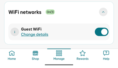

No because the EE app doesn't give even me that option. Under wifi I only get 1 slider for Guest.
I've now made the change to enable compatible network via the local Web interface.

@Majhaar : Compatible WiFi is to be found on the router itself under Advanced > Wireless Settings, not the app.
Yes I found it this morning - but the above linked instructions state you CAN do it in the app.
