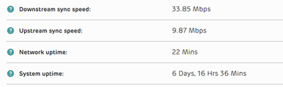

Hi, the internet is connected now straight from the master socket into the smart hub plus, and our internet has been great for the past 6 days locked at 75mbps down and 14 upload, but it has just gone down again about 20 minutes ago, we are back down to 34mbps down and 10mbps upload
XRaySpeX
EE Community Star
EE Community Star
The DLM system has put you on a banded profile in response to past errors on your line, at the top of the up to 35 Meg band of these VDSL Banded Profiles. You need to give the DLM time to relent & remove any banding. If your sync speed at the test socket remains stuck at the same speed for 10 days you should ask EE to investigate the underlying fault. If a fault is found and fixed then the OR engineer may request a DLM reset. However should significant errors persist the DLM will reapply banding.
