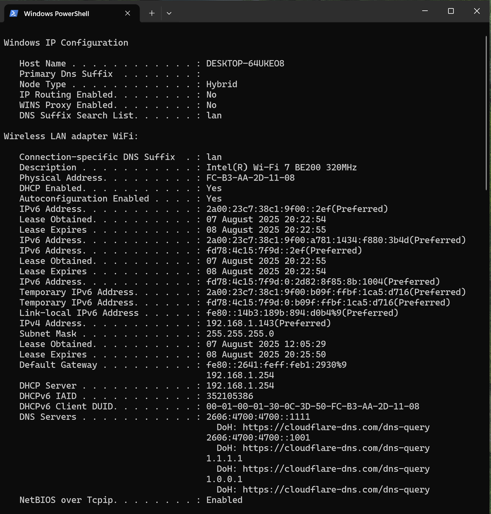

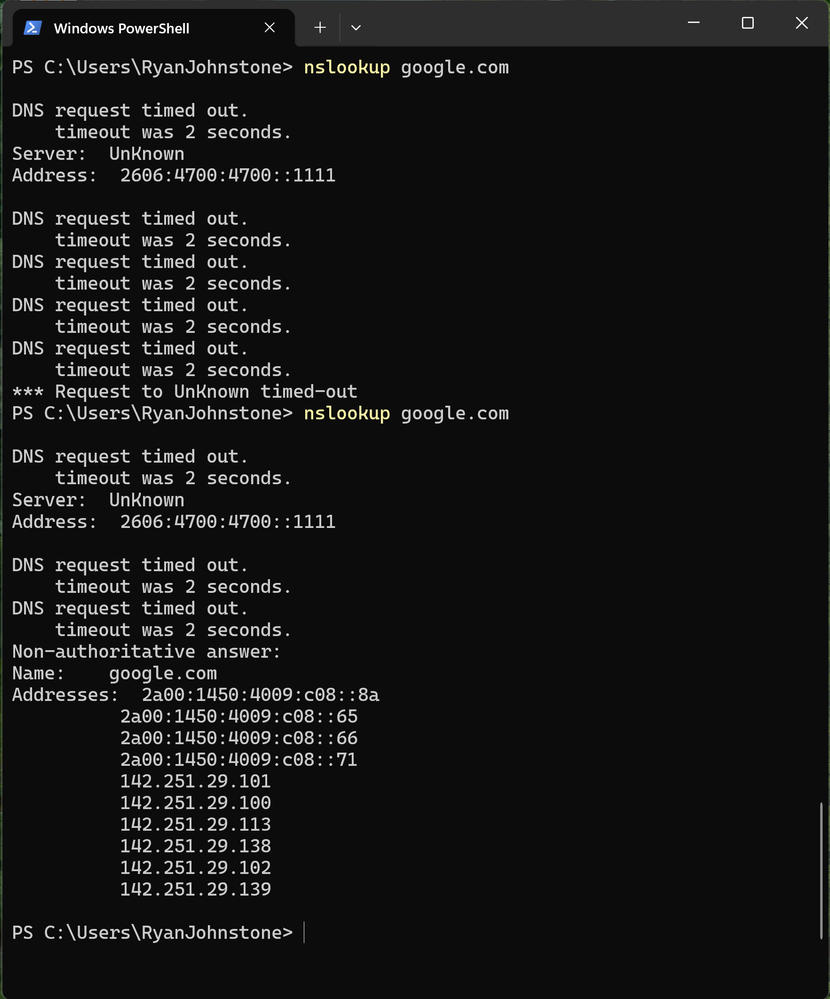

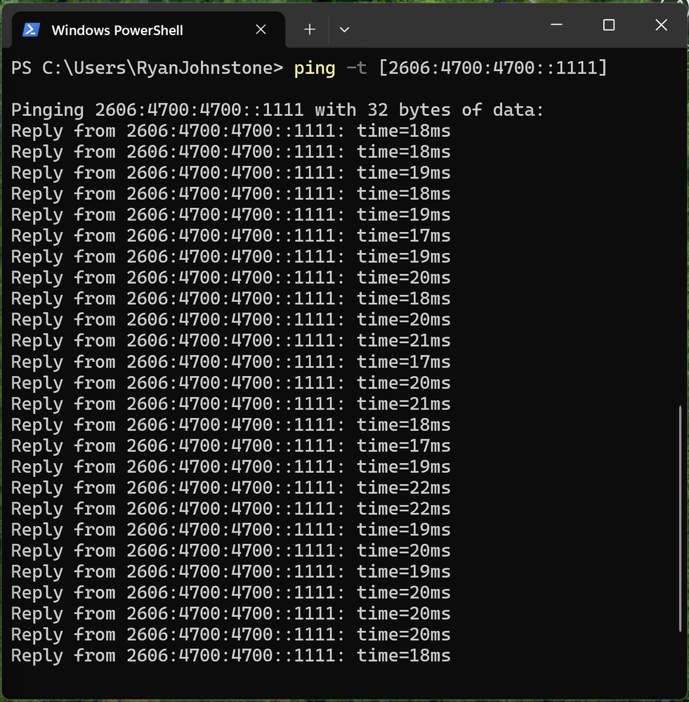

I am also seeing the exact same issue on my 1.6Gbps service.
I reported this by phone EE on the 31st July and after struggling to get anyone in technical support to understand what I was trying to explain to them I eventually got them to send me out a new Smart Hub Pro which I installed on the morning on the 6th August.
I optimistically believed the problem was with the original router until I got up this morning and have noticed the problem happening again. It crossed my mind that there was perhaps an automatic firmware upgrade in the period between installing the router and now but there is no record in the logs that this has been the case. The current firmware version is being reported as r2.64.6-R-1303886-PROD-1 and it says N/A under Firmware updated.
As with @allamavortex, there is no difference between using the router as the resolver or using a third-party (I've tried Google, Cloudflare, OpenDNS and Quad9) and it makes no difference if I use DNS over HTTPS or DNS over TLS. I've also tried disabling IPv6 to no avail. I haven't had the time, and don't particularly want to have to set up my own local DHCP server to solve this, but if I find some time over the weekend, I'll probably give it a shot even though it wouldn't be providing the clients any information different than they already received from the router's DHCP server (except different DNS servers, although these have been set manually on the clients anyway).
I'm eager to find out what is causing the issue because while I can understand (but would be uneasy about) the router could try and intercept a standard DNS query, I don't understanding the mechanisms of it being able to do very much at all with an encrypted DNS over HTTPS (or DNS over TLS) query. It certainly can't be decrypting it, analysing it and passing it on as I've not installed any client-side certificates that would be required for this to happen unnoticed.
I'm going to have another go with EE technical support when they open this morning but I'm not expecting much.
Screenshot 2025-08-08 035237.pngScreenshot 2025-08-08 035312.pngScreenshot 2025-08-08 035323.png
