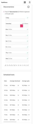

Thanks, will do that. The connection doesn't seem to be dropping as I have a Samknows Whitebox which monitors my connection, it just seems to be wifi from what I can tell. I had a disconnection yesterday but that was due to me resetting the router to default.
@C0RN1SHMAN Why, that does not have the correct interface on it so get it off the connection!
Not thinking, you're correct as it only measures from the router via ethernet. So only if it loses sync 😔
