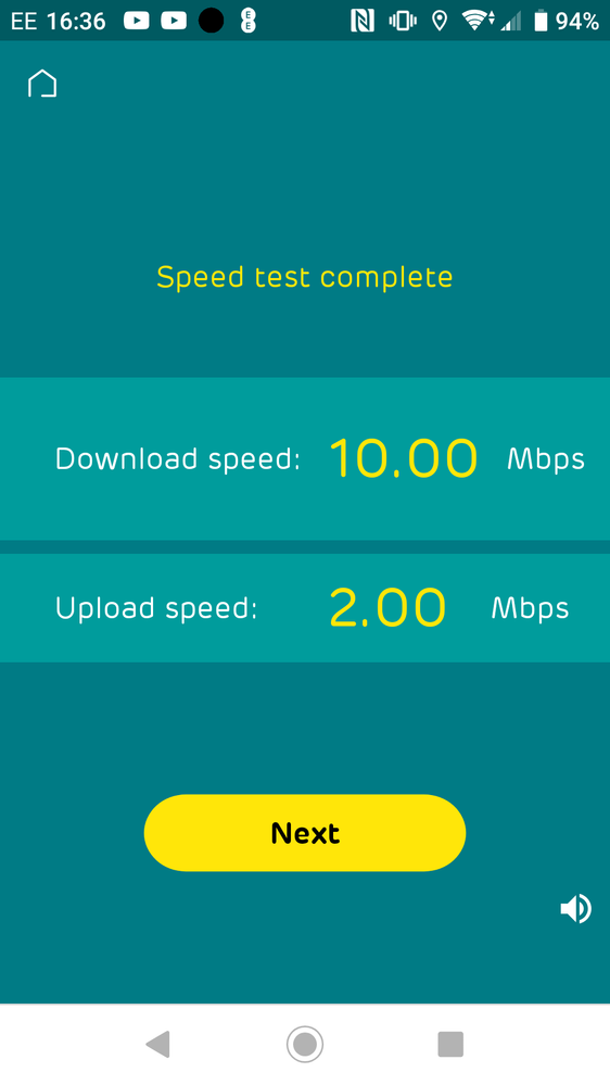

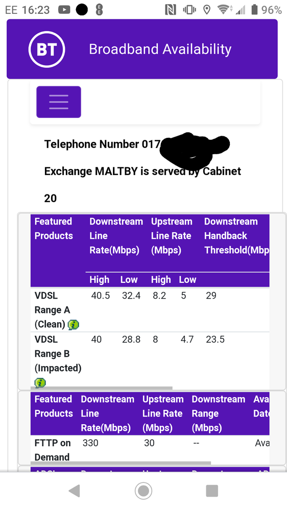

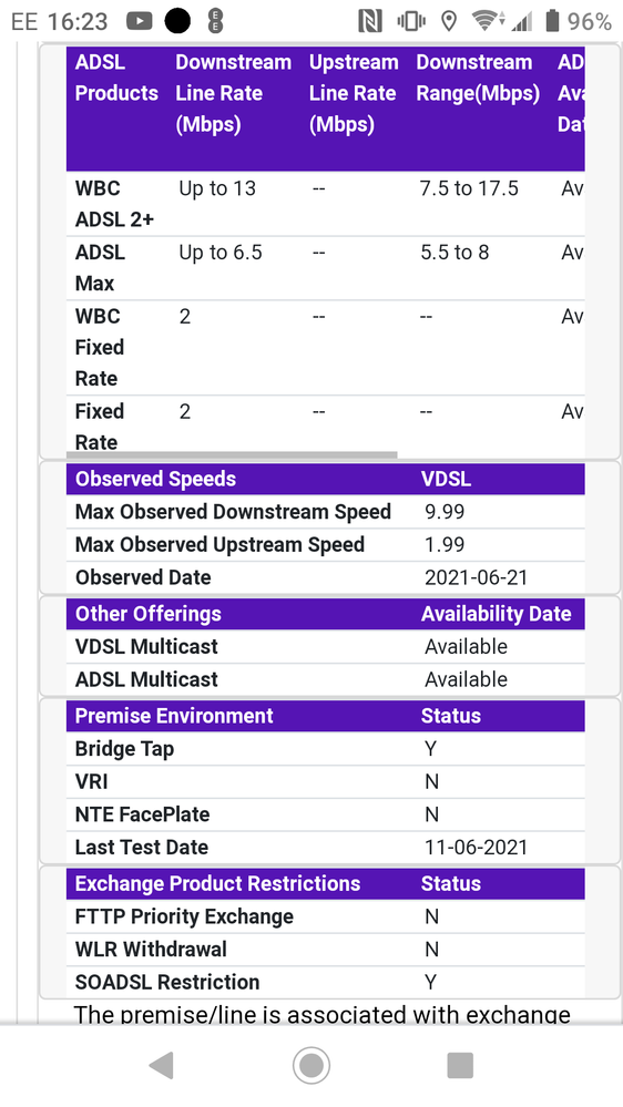

I've just upgraded my package on the 8th June and Internet was fast could stream at 4k and everything then all of a sudden Internet slow again same as my last package im sure its something to do with the exchange or green box I'm connected to I'm providing photos of my speed and bt wholesale checker

Still the same it's really puzzling my last week when first put it on speeds were 21,25,23 and my upload was always around 5

Your router is still using readytoconnect rather than your username and password. A factory reset might pull through your username and password.
Your line is being restricted to 10/2 either by DLM or the wrong configuration.
