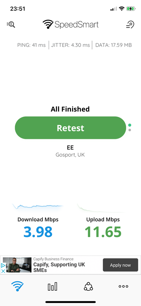

The upload speed is currently faster than the download. Can someone please sort out my connection. It’s been fine for the last 9 months but since some engineers have been doing “maintenance” over the last 2 months it’s been borked.
This is via 4G Router. Apparently your team say there isn’t a problem. I beg to differ!

This is a screenshot of a speed test. It isn’t appearing on the post.
3.98Mbps down
11.65Mbps up

When the measured upload speed is higher than the measured download speed, this is a sure sign of a congested network due to the high number of users out and about.
I frequently observed this situation with my previous service provider to a much worse extent (sub 1 Mbps at times).
Previous workarounds which succeeded for me were to force a switch to 3G which apparently is much less congested, or a restart of the router to cause it to pick a new cell tower to connect to. Good luck! 🤓
