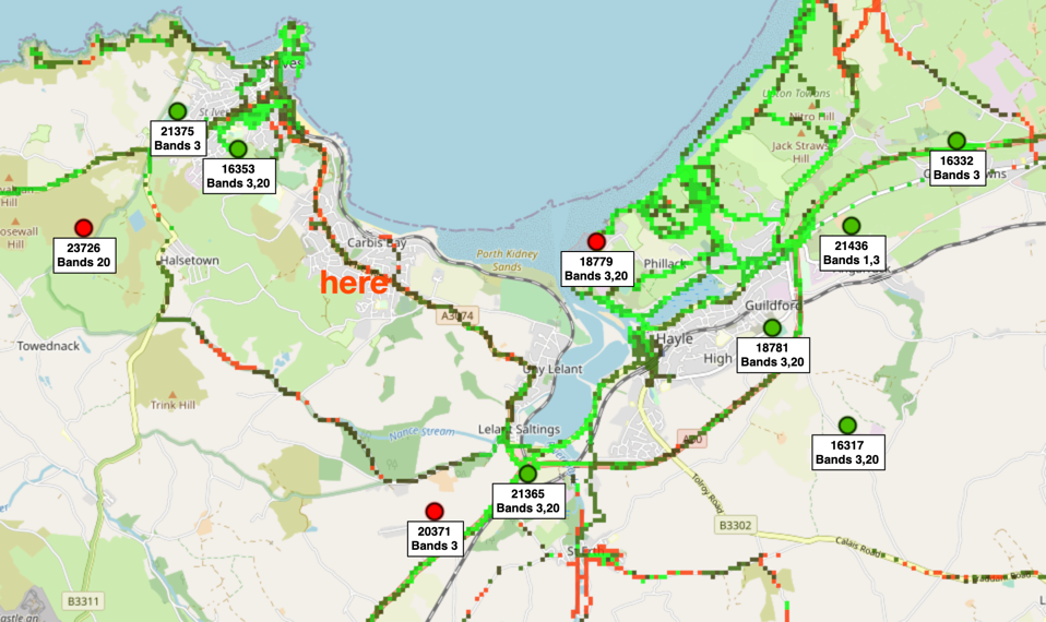

cellmapper.net is good for checking the coverage and location of well-known, established cell towers. If you can obtain the cellid and other details of the cell tower you are connected to, opencellid.org is good for locating newer towers. It's likely the tower you are connecting to is further than you think.
Both cellmapper.net and the opensignal app are good for checking how things look averaged over a certain medium period of time.

Thanks for sharing those tools. Here are the results. I'm not sure exactly what this means but I seem to be in the middle of them all.

I did have a brief check of your local serving sites before my previous post, there seems to be plenty of scope for additional capacity to be added should it be required. But that's not necessarily a quick fix - it does depend on the physical site config and other factors.
There's nothing inherently wrong with being in-between many sites - your issue seems to be one of capacity/spectrum and not coverage.

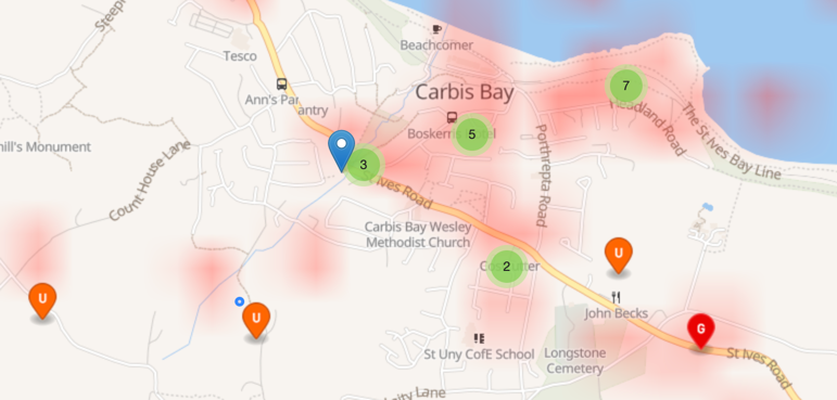

As you investigate your fixed line options, the cellmapper picture has just appeared for me and there seem to be pockets of red in your locality which suggests there may be the coinciding of capacity issues (4 Mbps down vs 11 Mbps up, I actually only mention capacity here in deference to "There's nothing inherently wrong with being in-between many sites - your issue seems to be one of capacity/spectrum and not coverage.") with signal issues (red on cellmapper.net). Certainly a large number of lost packets would suggest a signal issue.

Red trails on a CM plot are an indicator of poor RX quality and nothing directly to do with any DL congestion - they also seem to be in a different location to where the OP is resident.
