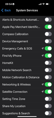

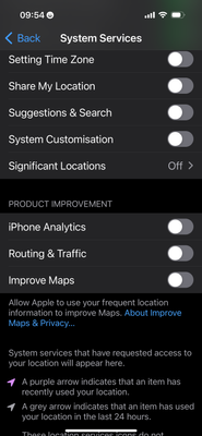

Settings>Privacy & security>Location Services>System Services>. Turn off Mobile Network Search.   You can also turn off other items you think you don’t need.
If your device is searching for a network to connect to it will drain the battery.   I had this issue with a iPhone 4S and network reset resolved that.   Have you tried this ?
This is what’s off on my device.
