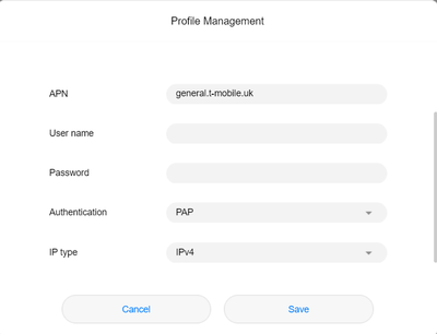

As a Test only and without using any VPN, set up another APN Profile on the Router as follows -
APN Profile Name = something like TM IPV4 NoPass
APN = general.t-mobile.uk
User Name = leave it blank
Password = leave it blank
Type = IPV4
Authentication = PAP
Save it, set as Default, Reboot the Router, Test and report back your findings.

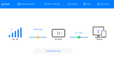

Hi Chris,
Many thanks for your reply! For the APN profile, I double checked, and they are correct. I tried your configuration without using vpn,  it shows 'Profile invalid' and under EE 3g, it is same circumstance.
