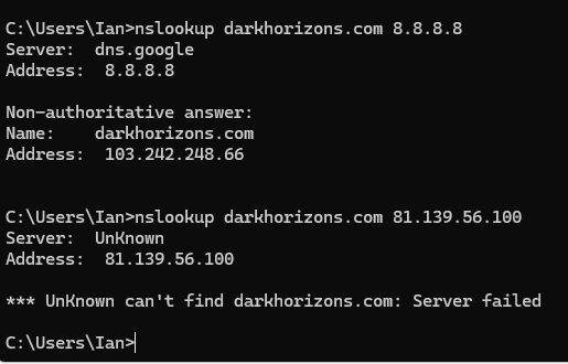

I'm seeing DNS issues to that site using the default EE DNS servers, which would tie in with the problem only being experienced on EE.   Google DNS servers resolve the domain OK at this time.
That would explain why other providers might be getting to the site OK because they will be using their own DNS servers or maybe those of the likes of Google as I did in my test.
Also, if EE users have reconfigured their hubs to use (say) the Google DNS servers instead of the default EE ones which anyone can do, they wont be seeing the fault.
It will likely sort itself out.

@soupladel  I've noticed the DNS is now resolving correctly on the EE DNS servers and I can now get to the service OK, so as I expected, whatever the DNS fault was has sorted itself.
