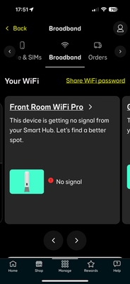

I’m stumped with this. According to the EE app (manage, broadband) both my boosters show as ‘getting no signal’, if I click on them, they show as online (confirmed by the aqua light on the boosters) and that devices are connected to them and working.
I’m not sure if this is a bug, or if something is wrong with the setup? I do seem to have lots of issues with speeds slowing dawn over the course of a few days, fixed by a reboot of the main router.

@Tinbum73 Have a look on the web interface manager to see if it is showing anything different rather than relying on the app to try and get it correct. http://192.168.1.254
 and under advanced settings/advanced wireless, wifi extenders you may see what is going on with them, you will need the password to get access.

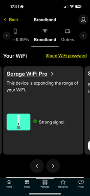

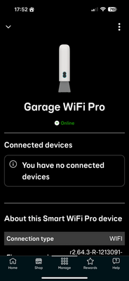

Last night I factory reset one of the boosters, which then showed online, but this morning my other booster which was showing online was showing no signal. Did a factory reset of that one, it now shows strong signal but the other one has now reverted to showing no signal.
I’ve looked at the browser page and both show connected, albeit the one that shows no signal in the app has 34 Devices connected and the one that shows online now has 0 devices.
Honestly baffled by the whole thing.
