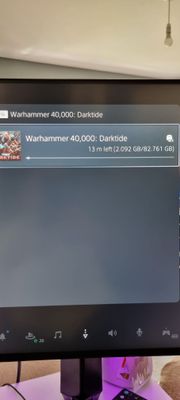

The speeds and pings are fine (confirmed on other devices and on my PS5 Pro via the connection test and in-game ping meters) yet downloading is impossible due to the fact it's stating it'll take hours to finish downloading. Earlier this week my PS5 Pro was working fine, my Series X and Switch 2 currently work even with this weird issue happening right now.
I use ethernet on all of my consoles and I even swapped the ethernet cable between my Series X and PS5 to rule out a router and/or ethernet cable problem yet the problem remains. Switching to wireless resulted in the exact same problem on my PS5 Pro - there was no difference. I even did a factory reset of my PS5 Pro which allowed me to download one game at normal speed before it slowed to an absolute crawl afterwards when the next queued item (only a 15gb DLC) resulted in the same lengthy time period.

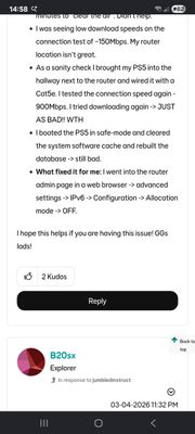

Sorry I was supposed to write ps5 pro with a smart 7 plus hub never had this issue before!! How do I access my admin hub doesn't work on my phone not secure?? Thanks
03-06-2026 03:27 PM - edited 03-06-2026 03:28 PM
@Gilly37 Ignore the securities warning, https://192.168.1.254 gets you there, phone but your choice what to access it with!
OP solution was posted, did that not work in your case?
03-06-2026 03:52 PM
hi yes ive tried turning off the allocation but had to turn bk on and it seemed to have fixed or reconnected the hub better download speed stable and flying again with multiple downloads tested with different games too
Thanks all

try this it worked for me

@ReadyUpEm did you reboot everything (including the PS5) after making the changes? Devices may well hold onto the old IPv6 allocations until you do so.
Do you see the issue whether the PS5 is wired or wireless?
