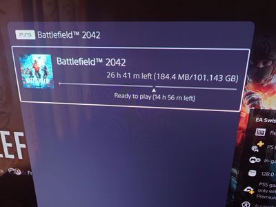

The speeds and pings are fine (confirmed on other devices and on my PS5 Pro via the connection test and in-game ping meters) yet downloading is impossible due to the fact it's stating it'll take hours to finish downloading. Earlier this week my PS5 Pro was working fine, my Series X and Switch 2 currently work even with this weird issue happening right now.

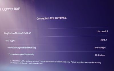

The PS5 shows me perfectly fine speeds via it's test as stated prior, a real head scratcher:
Although I'm happy to confirm my Series X and Switch 2 still download as expected even today so nothing is amiss in terms of my setup. My PS5 Pro was working earlier this week, there was no lead up to, rhyme or reason when it changed - I just tried to download something and then it hung on calculating longer than usual then the ridiculous download wait times appeared.

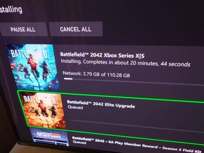

Series X example with the same game:

The PS5 Pro is on ethernet like my Series X and Switch 2, I've done a restart (this morning, I forgot to state) yet the issue remains. My Series X and Switch 2 happily download as expected, its why I feel the drastic shift earlier this week was enough to make me question was it a mere coincidence or is there an issue between EE and PlayStation Network?

@MarkCleg Your pictures are all cleared now, so connection looks good Ethernet wise PS5 to the Plus hub 20 minutes for download is well acceptable also...
