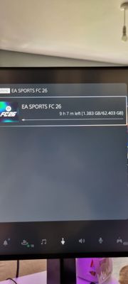

I'm on EE's 900 core full fibre, using the Smart Hub 7 Plus SH35A with the latest firmware (confirmed by a quick Google search).
The speeds and pings are fine (confirmed on other devices and on my PS5 Pro via the connection test and in-game ping meters) yet downloading is impossible due to the fact it's stating it'll take hours to finish downloading. Earlier this week my PS5 Pro was working fine, my Series X and Switch 2 currently work even with this weird issue happening right now.
I use ethernet on all of my consoles and I even swapped the ethernet cable between my Series X and PS5 to rule out a router and/or ethernet cable problem yet the problem remains. Switching to wireless resulted in the exact same problem on my PS5 Pro - there was no difference. I even did a factory reset of my PS5 Pro which allowed me to download one game at normal speed before it slowed to an absolute crawl afterwards when the next queued item (only a 15gb DLC) resulted in the same lengthy time period.

Just "up"graded from 500 to 900 today and having the same problems, I change ports, change cables, remove all but one LAN cable and still it's taking 20 plus hours to download a 60gb game, one which took hardly enough to make a butty on my previous 500 plan. Speeds are around 880 to 910 on ethernet but only 170 over WiFi, even over ethernet and showing great speeds it's pretending to be dual up. This really isn't good enough I'd rather have my 500 back which was always just over 500 and never skipped a beat.
