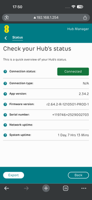

Gives you another avenue to test as you have NO idea if the Pro Hub is goosed, or the Ethernet cable is bad, but you can web to the EE Pro router on http://192.168.1.254 and see the interface sync to the ONT should be on the 2.5Gb/s setting.

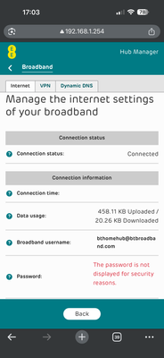

 Thanks. I don't see anything regarding the ONT sync speed but it has been sending tiny bits of data up/down it seems or at least something has happened.

The ONT link speed con be found on the Home > Status page.
 Not sure if this helps at all?
Post your full router stats:
  • For a SmartHub: login and go to Advanced Settings > Technical Log > Information. Obscure your names & any numbers in the BB Username & also the SSIDs. .

@PrettyGreen47 Very old wifi 7 Pro hub with the stated FW that it has, way back in time, list is below. Wan Link speed and in the status screen, 1000 for Gb/s 2500 for the 2.5Gb/s.
