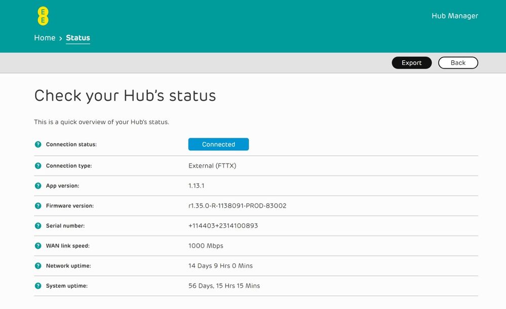

@PrettyGreen47 Hub thinks you are connected to the wan, so is it still flashing orange, say's you are up 1 day plus some hours ago?
@PrettyGreen47 What Tp-Link model do you have, say and i will go look on there site? But it does say your EE Hub is connected so it's good to go as far as EE are concerned.

@PrettyGreen47 Have a read at the linked post, the 1.6Gb/s package went down when they moved that package and user's to the new service, just wondering now if you are caught in this loop as a new connection to it.
1.6 package down since yesterday - The EE Community
Yeah, it's definitely an odd one, but no IP so it can't be surely?
My TP link is a BE3600 WiFi 7 jobby, LINK
Thanks for the help. If it is getting a connection then it's probably a waste of time them sending Openreach back out right? The loop you linked to sounds more like it's not provisioning correctly?
I could be way off because I don't know how the other end of the fibre works but it feels like OR visiting isn't going to gain anything and the executive office are trying to kick the can down the road a bit.

@PrettyGreen47 Vlan will be off you do not use it at all with the settings.
How many times must we tell you that VLAN ID is not used for OR FTTP, only for FTTC?
@PrettyGreen47 Linked an older AX model but should be similar, would be better if you used a browser on the laptop instead off the phone.
Look at the connected fttx and the network uptime.Look at the connected fttx and the network uptime.
