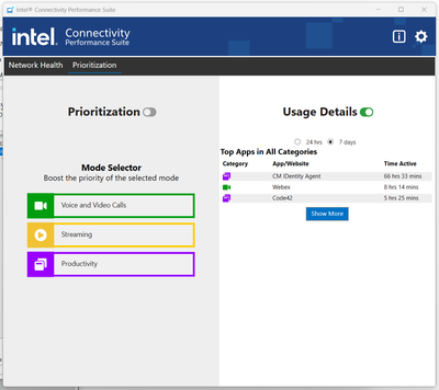

The only options I see in Intel Connectivity Performance Suite are:
    1. to turn on/off prioritisation.
    2. monitor usage details on/off.
I've turned off prioritisation and retested.
I must admit I was very sceptical about this, as the alternative path (Vodafone 4G) worked so well and that the problem appeared to be related to the QoS marking, so it only made sense that the issue was occuring downstream.
It looks like you found the problem!    I wish I understood how, I'm starting to think the person that I tested with over 4G was wrong and the problem did exist there too!

You're right TT, I just took a wireshark capture of the 'good' webex session I'm in at the moment, and all my audio & video packets are showing as DSCP 0. That's why it's working correctly. I guess it was the Intel Connectivity Performance Suite allowing the WebEx application packets be honored at DSCP 46 and 38 before (which were being dropped downstream).
So while I'm happy I have a fix workaround, the network is still performing badly.  That explains why it worked OK with the Vodafone 4G Wifi tethering path.
Profile closed
Not applicable
It seems that the Intel Connectivity Performance Suite workaround is temporary. I've not changed anything but the DSCP settings have come back this morning and my WebEx experience is bad again.

Morning TT 🙂  It's a work laptop, fully managed by the IT dept. The real fix is EE fixing the QoS  PHB. They never get back to me when I call support, they say they've escalated, but no one ever calls back. I'm getting closer and closer to moving ISPs.
We found similar in testing - we were stripping the DSCP from the registry but GPO/Intune came back later and re-applied.
It might be worth toggling it on the off again in Intel suite, checking for any QoS settings in the registry at HKLM\Software\Policies\Microsoft\Windows\QoS
You can check if if its GPO related
gpresult /H gp.html
Intune is a bit tricker, but you can find the last bunch of policies applied at HKEY_LOCAL_MACHINE\SOFTWARE\Microsoft\Provisioning\NodeCache\CSP\Device\MS DM Server\Nodes
deezle
Investigator
Investigator
On my work laptop, Advanced connection manager is already disabled, but when I try and disable prioritisation, I can actually see the setting being force toggled back on & off. So no joy for me.
