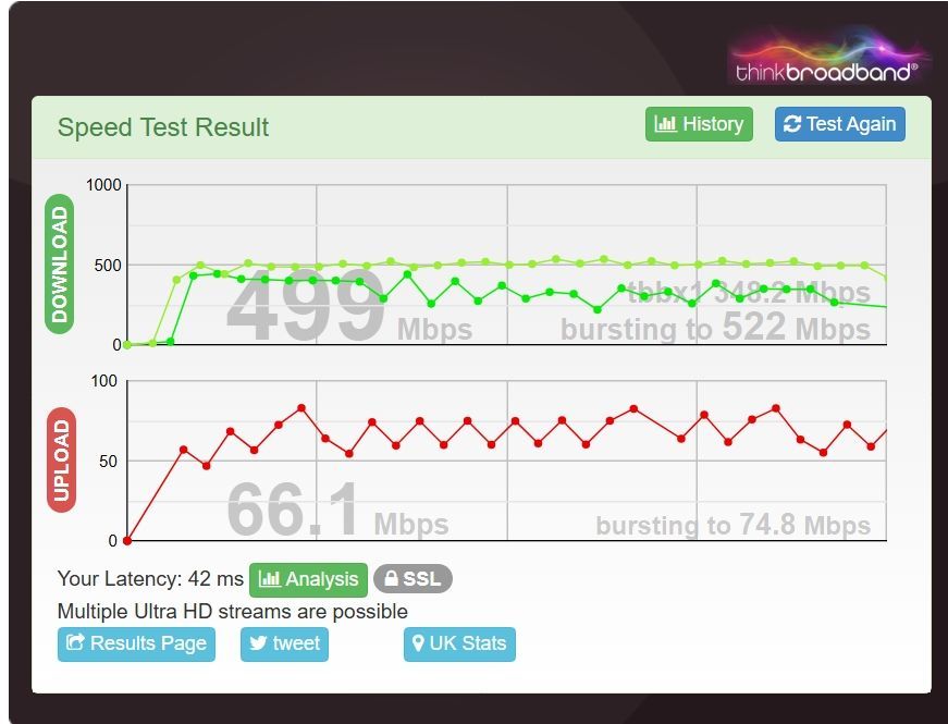

Hi @Peter_W,
I managed to link the laptop directly to the ONT, establish a PPPoE  connection OK and run some tests.
The Teams performance was similar to via either the EE or Asus router, perhaps slightly better, although definitely with noticeable stutter on both video and audio.
General performance test results were:
Fast.com - 520 Mbps
Speedtest.net: https://www.speedtest.net/result/17700510603
Thinkbroadband: https://www.thinkbroadband.com/speedtest/1746549527141756555
At the end of the session I tried another call using a 4G hotspot via my phone, and as previously, the Teams call quality was excellent - very clearly superior to when using the direct connection via the ONT.
Any thoughts on what to try next, or whether this may be pointing towards where a problem may lie?

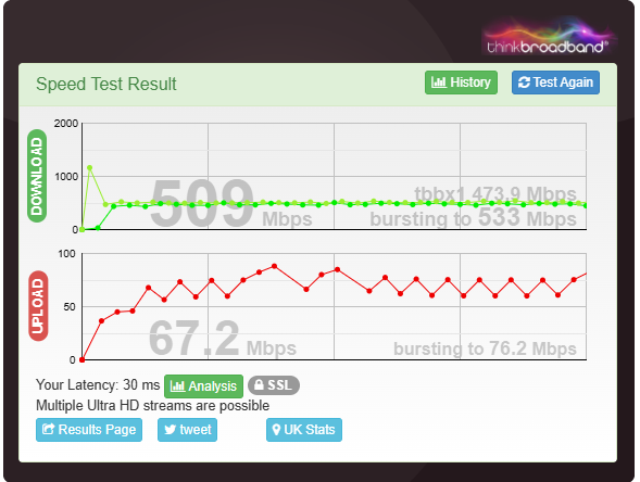

@QuantumPhys As far as i can see, with the copy that you have posted and below, you have a serious upload problem and it is not going to get better until you get that fixed. Download may be ok but for teams/zoom etc the upload is just as important. Question for you do you have or are you using any kind of wi-fi booster device on the network?
Fast.com - 520 Mbps
Thanks, ""
JimM11
Community Hero
Community Hero

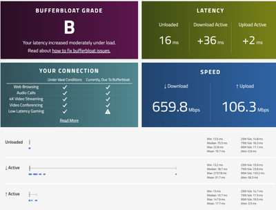

@QuantumPhys When cleared for viewing you can take a look see. Also the link below to a very detailed speed test and look closely at the details boxes for the upload side of the speed test's. There are 2 thing's that you need to do, 1. is network connect your laptop to the Pro router that you have, 2. vary the testing times to get a picture off what is going on connection wise. 3. do not care what bundle you say you have got, there is an upload issue, may not be you or your home or your connection but there is something going on around your fibre.
https://speed.cloudflare.com/
https://www.waveform.com/tools/bufferbloat
FF500 on Sky No1 at 6.30amFF500 on Sky No1 at 6.30amFF500 on Sky No2 at 6.30amFF500 on Sky No2 at 6.30am
JimM11
Community Hero
Community Hero
@QuantumPhys Two quick captures but his time on a PC with a Ethernet direct connection. Again when cleared for viewing.
FF500 on Sky No1 at 8.30amFF500 on Sky No1 at 8.30amFF500 on Sky No1 at 8.30amFF500 on Sky No1 at 8.30am

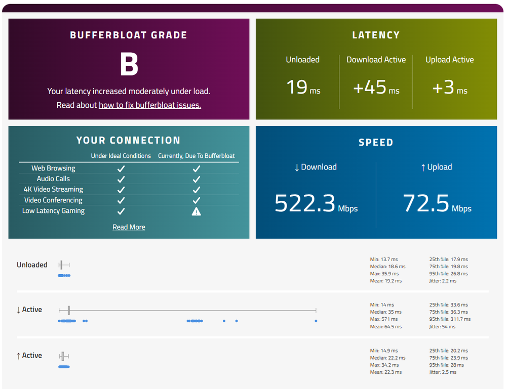

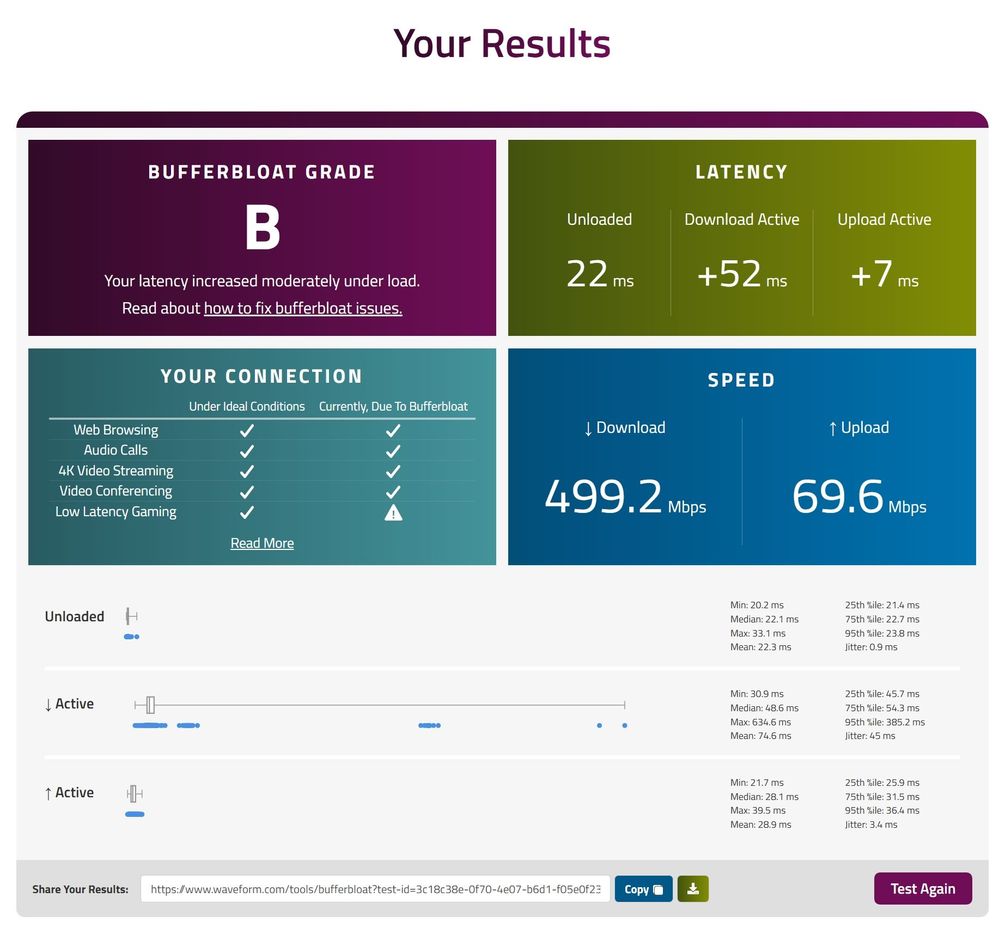

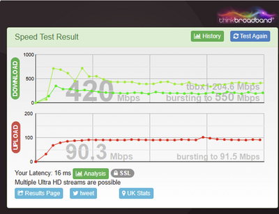

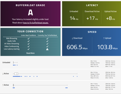

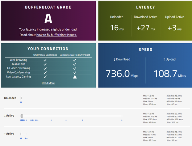

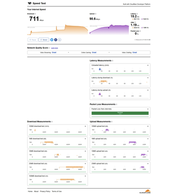

Hi @JimM11 - here are some outputs from tests run at different times of day. Each time the laptop is connected by Ethernet cable to the Smart Hub Plus.
1000 in the morning
1200 noon
2000 in the evening
I can't see anything obvious in these.
Teams / Zoom calls are poor quality each time.
If I use a VPN the quality is fine but because it's a corporate laptop I can only do this when the VPN client is running on my old Asus router, either with the Asus router connected to the ONT and using PPPoE or with the Asus router acting as an access point to the Smart Hub Plus. (The issues with Teams/Zoom persist when the Asus router is connected to the ONT but without the VPN running.)
