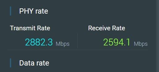

@Memnon Listen to the support if you wish, they could be right but that's all up to you. a 1Gb/s Ethernet connection you will get around the 980Mb/s mark if the device is capable of sustaining that, a 2.5Gb/s Ethernet port in your PC will get you up to the Rated speed that OR apply to the ONT which is 1.8Gb/s with the throughput at the 1.6Gb/s after the overheads.
Combined wireless/wired if your PC can do it then full speed..... External pushing is what you expect, see the Picture below when it gets cleared this is what i do Internal on a FF500 connection using Asus Router. My old Samsung A54 rated at 1200Mb/s nearly gets there on a good day, when the system wants to play. External around the 520Mb/s mark that is all the pipe clamp allows for me!
Asus speed that can be done.
