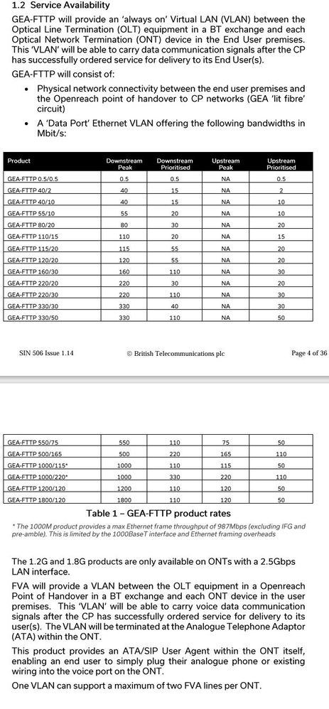

30-05-2026 02:48 PM - edited 30-05-2026 02:52 PM
@jaybeetooee Ok think i have you now, the system is showing you 300/50Mb/s on the app when working correctly speed to the hub, but when it goes what is the values you see? There is a down / up, the FF150 is 150/30 i believe controlled by OR and the ONT. See when cleared for viewing.
OR Speed profiles.
