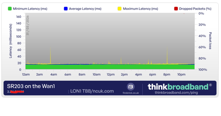

@karis6197 Here is about 1 week ago, using the old sky Hub connected on the wan, all the Asus sitting double NAT on the back off it, unfortunate the BT/EE hubs do NOT allow BQM's on them.
Sky's old SR203 on the wan connection with everything else sitting behind it, testing the SR for a sky Customer.
