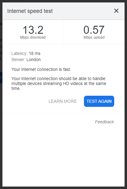

I'm suffering terrible upload speeds on my home fibre broadband connection. The cabinet that serves my house is about 1km away; we should have fibre from the exchange to the cabinet and then copper wire from cabinet up the road to our house. Due to the 1km of old copper cable (partly burried, partly overhead), I'm not expecting to get anywhere near the "super fast" speeds marketed.
My download speed is perfectly adequate for my needs, considering the location of our house (which hovers reliably within the range 9-13Mbps). However, my upload speed is diabolical, severly hampering my efforts of working from home. I can't share my video on confrence calls, and I can't upload files bigger than a few megabytes because it takes too long and whilst uploading anything, the broadband grinds to a halt for anything/anyone else in the house. My data throughput rates for upload speed used to hover around 2Mbps (perfectly adequate for my needs), but recently have dropped right down to 0.5Mbps (at best).
A quick speed test taken just a moment ago using Google speed test:
Google speed test reportGoogle speed test report

Data rate0.63 Mbps/14.63 Mbps
Maximum Data rate0.6 Mbps/16.1 Mbps
Noise margin (up/down)6.5/8.1
Line attenuation (up/down)45.4/31.0
Signal attenuation (up/down)6.3/24.8

Any noise on your line? 17070 option 2, best with corded phone.

Yes, the upstream is rather slow.
Locate the hidden test socket that is revealed when you remove the bottom half of the split faceplate (2 screws or press tabs) of your master socket. Only do this if you have a split faceplate. Do you have any extension sockets in the home even if unused? Are there any wires connected to back of faceplate of master socket?
Try the BT Quiet Line Test (QLT), dial 17070 Opt 2, preferably with a corded phone, in the test socket with the router disconnected. If there is any noise, report it to your landline provider as a voice fault (don't mention Broadband). Often sorting out voice faults will fix the Broadband as well.
Reboot the router & plug it into the test socket. Post the full router stats & System Uptime when plugged into test socket.
