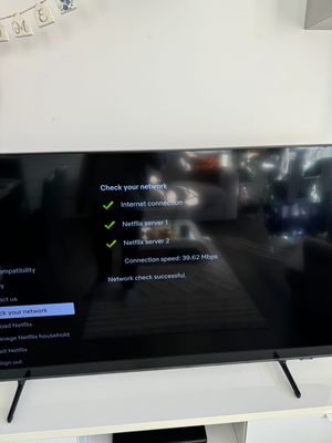

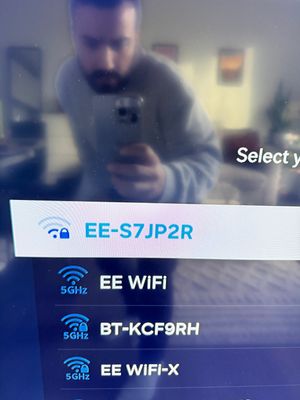

I found your email address on a EE community forum regarding issues with EE internet and issues with the EE tv box. I have EE full fibre package 150 along with full works tv with a main box and mini box. I have noticed a lot of pixelation issues when watching through the tv box and signal drop off it seems, which is causing my viewing experience to be rather awful.
I have checked my speeds via the tv box app for Netflix and I'm pulling 130-140mb, I have the same speeds via the mini box in the other room. The router is not far away from either tvs, however I find that when I run the same speed test through the smart tv Netflix app I get a massive drop off, my speeds are showing 30-40mb. This is almost 100mb drop.
So I don't know whether I'm getting this drop off throughout the whole property for my devices or whether it's just my tvs that are unable to pull the speeds that the tv boxes are pulling, which is giving me pixelated pictures and sound out of sync issues. I have brand new tvs so I'm guessing the newest technology is installed inside them. I had an EE engineer come round and changed my settings from WiFi 6 to WiFi 5 no change. I have attached some pictures to show you the speeds and the pixelation issues. Everything is connected wirelessly.
I notice the pixelation issue is happening when watching sports and movies and it seems to be even worse when watching in 4k
