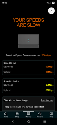

Internet speed reads between 93-97mbps in both down and up to the hub from outside. Model is the Smart hub 6. I've tried checking the fault in the area using the app but it errors out before completing and has said try again later for 4 days straight now. And the plan is Full Fibre Gigabit
02-10-2026 07:02 PM
This is what the speed test returns for me

And before the last 4 days, speeds were normal, usually at or a bit above 900mbps
02-10-2026 07:59 PM - edited 02-10-2026 08:03 PM
@jario5615 Have you reset the EE Hub and also the ONT, looks like the wan connection for either/both has synced on the 100Mb/s Ethernet port, if you were to web manager look at the status then that would tell you what the speed is at, should be 1000Mb/s....
Wan link speed 1000Mb/s is what you need to see.....

Yep reset both several times and no luck, still only getting a max of 97mb to the hub from the ONT

Here's what the WAN speed says. its getting 100 when it should be a lot more

@jario5615 Pictures have to be checked and cleared for viewing so currently not seen, just switch ONT off for 5 mins, hub as well start ONT first and when Power/Pon solid green start your EE Hub up after that, look see but you need 1000Mb/s on the wan if 100Mb/s then that is all you will ever get.
That is why a cable was sent, the EE CS suspected your cable was bad, starter for 10 as Bamber would have said.
