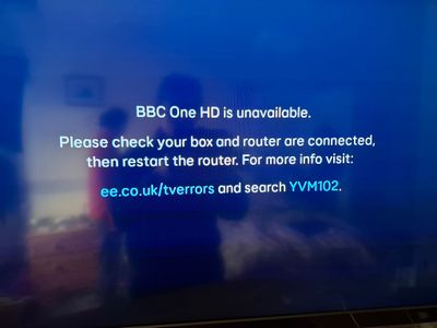

1. Is the error you're seeing YVM102?
2. When it happens, please go into the network settings and scan for wireless networks.  Does it work? Or does it list zero networks available?

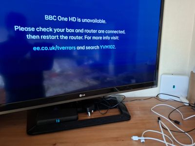

Yes its definitely YVM102 and doesn't show any active network in settings.NkiSent from my Galaxy
Gone down again this morning 0925. Attached screen shot, rebooting now. 

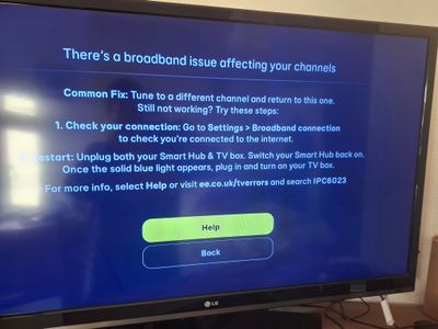

Hi after a period if relative stability the same issue is back YVM102.
Attached screen shot which shows hub is next to it and active. Not had any tech contact.
About to reboot.
 showing router.
