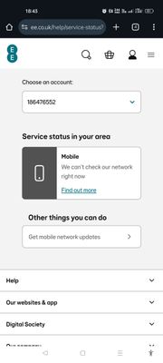

I think there's something wrong with the closest tower to Yelverton Road, Coventry.
I usually have no issues but starting Tuesday, the Internet keeps dropping out at random.
Has anyone had these issues recently?

Thanks for providing us with the screenshot @Alex1409.
Are you able to try from another device?
I have been able to successfully search my area.

No, I don't go around having 2-3 devices with me...
I was able to check the coverage from a different link...
There seems to be some sort of problem in the area but clicking on Find out More gets me that error again...
Once again, this started last week on Tuesday December 10, so it's obviously a new issue, not related to my phone or general coverage.
The SIM shows up as 4G but no data connection. I am receiving 2FA texts so that works... Don't know (and don't care) about calls...
It started working now, still get the same error... 6:50 pm.
7:35 pm and it died again...
From what I can tell, it disconnects me after about 20-30 minutes...
