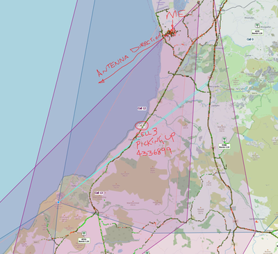

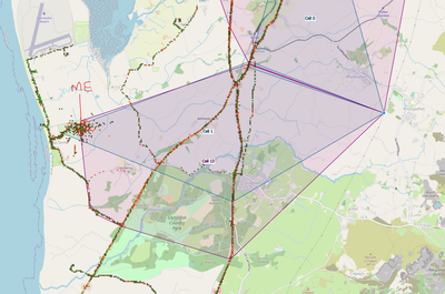

can anyone help me with this question. connected to the post above.
so i have my poynting xpol_v3_5g 2x2 pointing at one antenna, thats nearly 9 miles away, in ports 2 and 4. as you can guess, the speeds are really up and down, depending on weather and traffic. the antenna is pointing around SW of my location.
now have i read somewhere that the ports on the NR5103 are for different frequencies?
i want to do a test you see. so i get nothing from ports 1 and 3 with the antenna in its current position but to my east is a mast that my phone picks up, also on EE, although one bar, but it amazed me that this wasn't my strongest signal with the antenna. what i am thinking is plugging the cables into ports 1 and 3 trying the search again moving the antenna 360 to pick up the best signal.
to add to this here is my surroundings in a nutshell.
this is ports 2 and 4
i want to try this with 1 and 3
is this a mad theory?
maybe you would know if its worth a try @EssexBoyEE
[Mod edit: Image rejected due to it containing personal information.]

@S1GAR wrote - maybe you would know if its worth a try @EssexBoyEE
I cannot see your pics yet as they need to be approved for public viewing.
You mentioned in your previous Post that you are using Cable Splitters, these are not actual Splitters but are 2 lengths of Coax that are shorted together at the single plug end. So what you are doing is shorting out one of the Devices Transmitter and Receiver Port with another Port then trying to connect a Single Antenna to the 2 shorted Ports,
What EE Sites are you trying to connect to?, 4G, 5G? remember you cannot connect to a 5G Signal without first being connected to 4G, added to the fact that EE now use up to five different 5G Frequency Bands now, do you happen to know which 5G Bands are available in your location.

my pics have been taken off 😞
i was doing that but i dumped the splitters and went back to singles.
I am currently connected to eNB ID 16941 (4336899)
Cell Identifier 4336899 (0x422D03)
System Subtype LTE
PCI 191 (63/2)
Bandwidth 10 MHz
EARFCN 1815
Maximum Signal (RSRP) -74 dBm
Direction NW (318°)
Max / Avg DL Speed 24 Mbps / 8 Mbps
Max / Avg UL Speed 22 Mbps / 14 Mbps
First Seen Fri, 22 Oct 2021
Last Seen Mon, 26 Jun 2023
Actions
Delete Cell
Go to Cell
Notes Second Carrier B3
Uplink Frequency 1771.5 MHz
Downlink Frequency 1866.5 MHz
Frequency Band DCS (B3 FDD)
but, when at the location my phone picks up eNB 16949 but i cant remember what actual cell and i am not there at the moment to check. postcode xxxx xxx.
its a shame i cannot see the data i uploaded to cell mapper.
its all complex isnt it 🙂 my router is saying i am connected to 5g but i think this is more good 4g than actual 5g
my main thing is though if i am wasting my time using 1 and 3 and trying a search again. if it would give different results from 2 and 4 or if it wouldn't matter.
whats made me think this is if i am connected to the SW mast (xxxxx), that is far away, on 2 and 4 and 1 and 3 are for different frequencies that i am out range for, on that mast, then is it worth a go?
i am thinking of getting another 2x2 antenna if it did work.
@EssexBoyEE am i completely wrong here? i dont know enough about it you see.
[Mod edit: Please do not post personal information on the public board. Thanks!]
03-07-2023 02:39 PM - edited 03-07-2023 02:41 PM
Your Area rings a bell, we have spoken about your location before?, if so what was the outcome as I can't remember off hand.
The EE 2021 Router will report a 5G Signal if your within a 5G Signal Layer but this is no guarantee that you are actually connected to 5G, also EE Firmware restricts any 5G Signal Info, so on the Status Page it will only show 4G Signal RSRP, but it should show Carrier Agregation info, so it from that you can tell if you have a 5G Connection, ie, CA for 4G could be something like B3+B3, where as a 4+5G could be something like B3+B3+n78, where the later represents a 5G NR connection state.
Post up a Status Page Pic but omit any personal info like Phone Number or IMEI.
