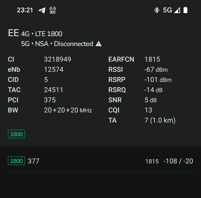

16-03-2024 08:51 PM - edited 16-03-2024 08:52 PM
Those screenshots show you're currently connected to 4G-B3 & B7 carriers on a site carrying dual-carrier B3 & B7, single-carrier B1.
All of which suggests your phone is preferring a 4G layer over 5G. It would be interesting to know whether your speeds are varying - traffic volumes could be a factor if so.

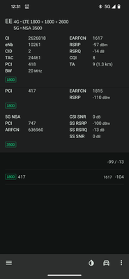

17-03-2024 12:41 PM
I'm out of home currently with the sim in my Pixel 6 Pro, just took the Overground train to central London. I've been checking NetMonster while I'm on the train. Before the train reached Surrey Quay, the station next to New Cross, the result stayed mostly the same, but when it came close to SQ, the app reported 5G NSA was then connected, I immediately did a SpeedTest and the result:

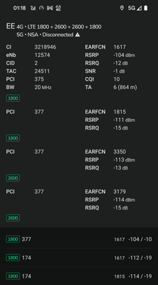

DC-B3 EARFCN 1815 + 1617) aggregated with B7 (most likely EARFCN 3350) is 80Mhz of bandwidth. Network Signal Guru would be an interesting view.
NR-3500 (N78) will likely be a single 40Mhz carrier.

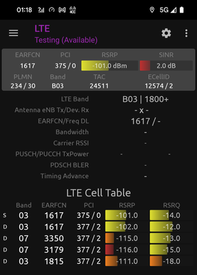

18-03-2024 01:38 AM
I've just done a speed test at around 1:18am at home, finally having a good result for once. However, I doubt it will remain this way throughout the rest of the day and importantly the evening based on the result I had on the last few days. SpeedTest, NetMonster, and Network Signal Guru screenshots:

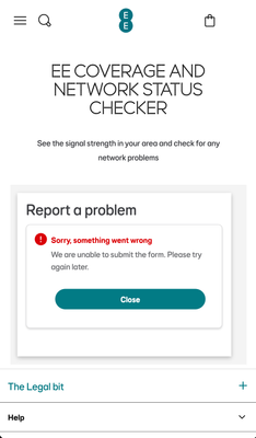

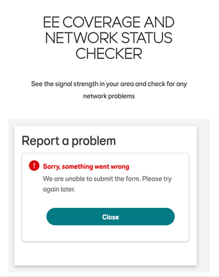

@Katie_B If you see this please let your colleagues know that I have yet to be able to report any coverage/status issue since it is still showing error at https://coverage.ee.co.uk/coverage/ee/report-fault when I try to submit one.
I'd love to stay with EE due to the excellent speed I've observed from other parts of the city, but if it cannot deliver some decent speed in places I spend most of my day in, I might be left with no choice but to look for alternatives. There are still weeks to go before my current 1-month contract ends. I look forward to resolving this issue.

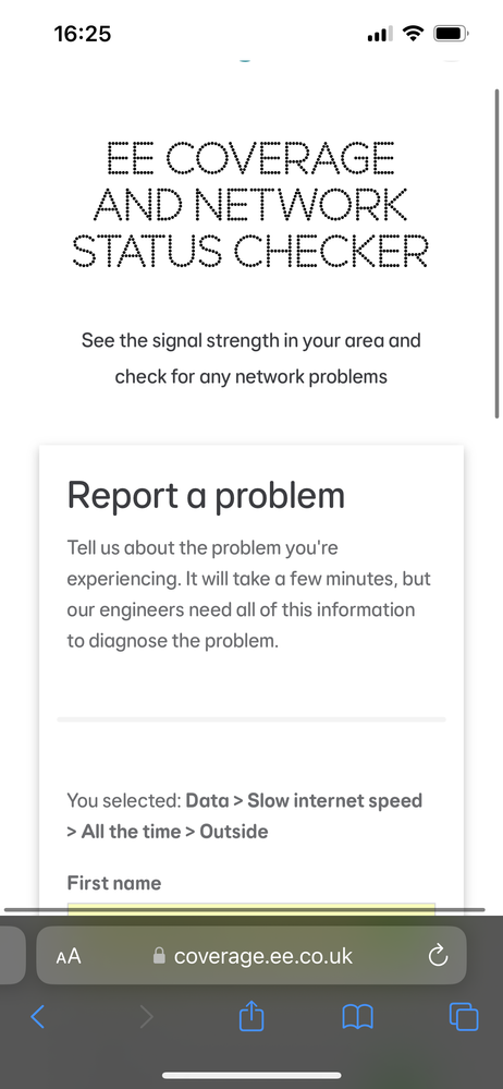

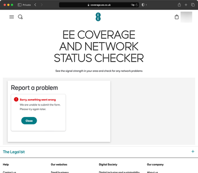

18-03-2024 04:32 PM
Hi @Christopher_G,
I'm not sure are you referring to the speedtest or the report page, I always turn off VPN for the best result. I just tried submitting a report again, but it all failed on both my Macbook and iPhone 13 Pro, with Chrome and Safari. And there was no VPN running on both devices:
iPhone Safari:
