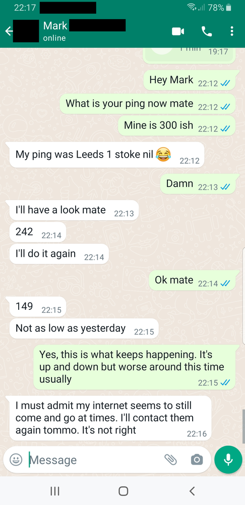

I have spoken to my two neighbours who live around 1/4 a mile from my location, who are also on EE 4G as we live in a rural area and there is no broadband or fibre available so the 4G internet is our only option. I asked them to do some ping tests and they also are experiencing the same issue, yet EE keep saying there's no problem.

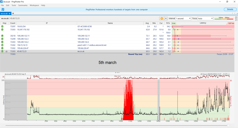

laptop pingplotter 04/03/24laptop pingplotter 05/03/24XBOX ping 05/03/24Ethernet model SignalNeighbours ping also on EE
Other neighbour Mark who lives 1/4 mile away

This is pretty much a 24 hour log. This all matches up with pingplotter which I'm running 24/7 logging all of this too.
Screenshot of this included.

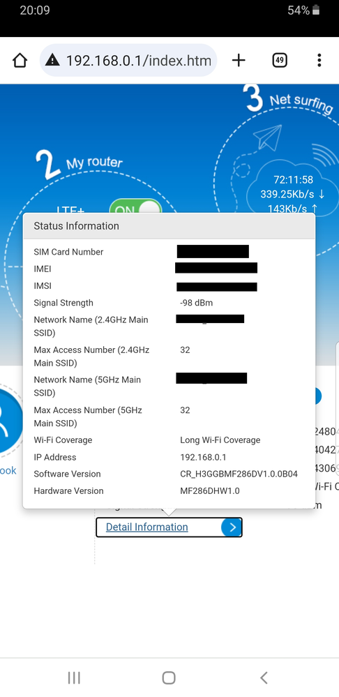

Output from the modem internals when the internet BAD at around 8:20PM
"network_type": "LTE_A",
"mcc": "234",
"mnc": "30",
"rssi": "69",
"rsrq": "-9.0",
"lte_rsrp": "-99",
"wan_lte_ca": "ca_activated",
"lte_ca_pcell_band": "3",
"lte_ca_pcell_bandwidth": "20.0",
"lte_ca_scell_band": "20",
"lte_ca_scell_bandwidth": "5.0",
"lte_ca_pcell_arfcn": "1617",
"lte_ca_scell_arfcn": "6225",
"Z_SINR": "24.6",
"Z_CELL_ID": "366",
"Z_eNB_id": "5079809",
"Z_rsrq": "-9.0",
"lte_ca_scell_info": "196,2,20,6225,5.0;"

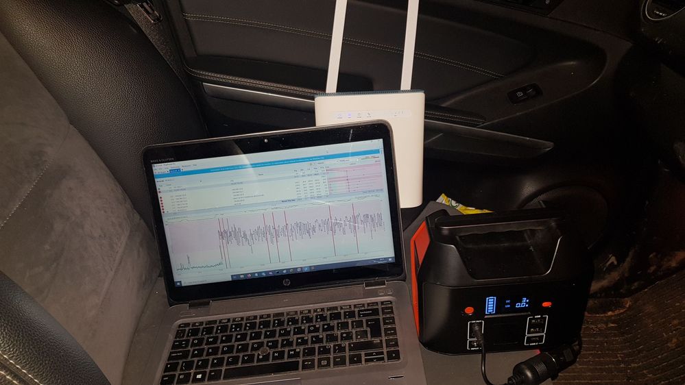

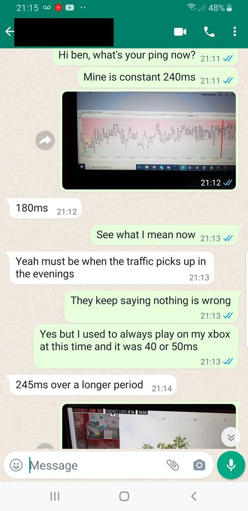

I even took the router, laptop and an external power supply and drove in a complete circle around the tower, and at one point was within 100M of the tower with the same results, and poor network latency and speeds.
Router + Laptop + PSU in car.
I also went to friend's house in the village, who have an EE phone, asked them to do a speed test, and they got exactly the same results I was getting. Low speeds, and high ping.

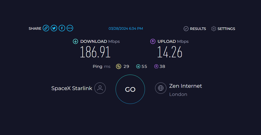

Well, I came up with a solution to this problem. Internet that works!
Starlink!
I purchased a Starlink system instead.
