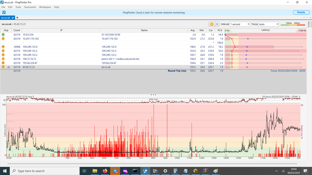

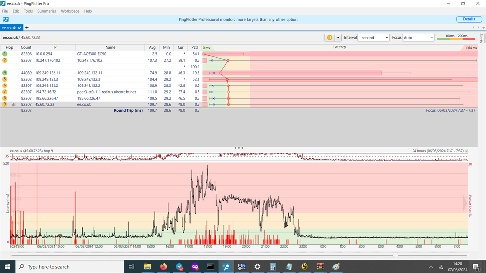

Everything works fine at 2AM in the morning! and the problems usually start to show around 6pm until 11pm on a weekday, and pretty much all day at the weekend. I've attached some pictures below of ping plotter, screenshots, etc.
laptop pingplotter 04/03/24
laptop pingplotter 05/03/24

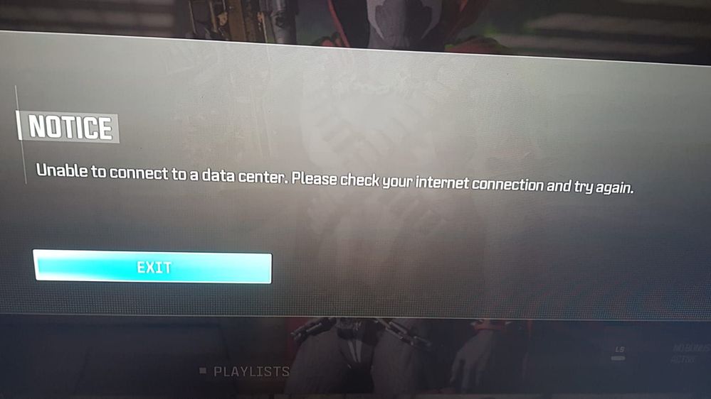

XBOX ping 05/03/24

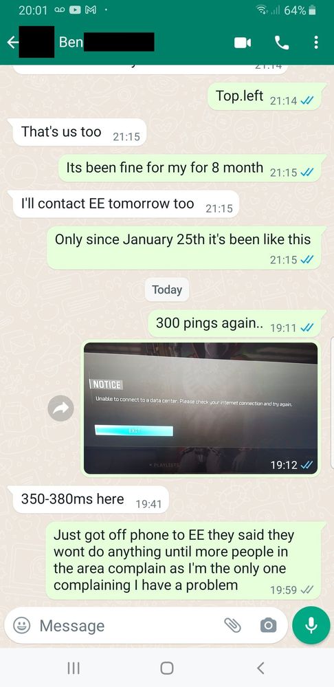

Neighbours ping also on EE

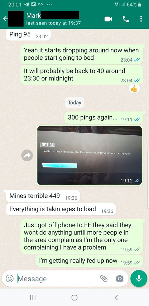

Other neighbour Mark who lives 1/4 mile away

there isn't really any other side affects, as TV will play OK due to the large buffer the streams use. I guess if I were doing a zoom call that would be affected or if I was doing VOIP or any other real time thing where network latency was important that would also be affected.
8 months prior my son and myself used to play on our XBOX's every night, and I always had the ping displayed in the top left as on the screenshot. I used to get 40-50ms. Since the 25th January the xbox has been unplayable now apart from if I play it at 2AM! It is like there is some bottleneck in the system that was not there prior to the 25th Jan.

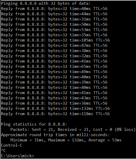

If I manually ping a server such as google DNS (8.8.8.8) I also get terrible results at these times where it used to be constant 30-40ms.
Ping during peak times:
Ping from a few moments ago (which still has a few spikes in it)

06-03-2024 08:15 PM
Phoned EE again, they said they need more people to complain before they will investigate...
Another ping plot from today... same issue as usual...
Ping plot from 06/03/2024
Asked my neighbour Ben what his ping is like (He is on EE 4G too)Neighbour who lives 1/4 mile away
Asked my other nearest neighbour Mark what his internet was like too..Another neighbour who again lives 1/4 mile away
XBOX won't even connect it's that bad...XBOX won't connect

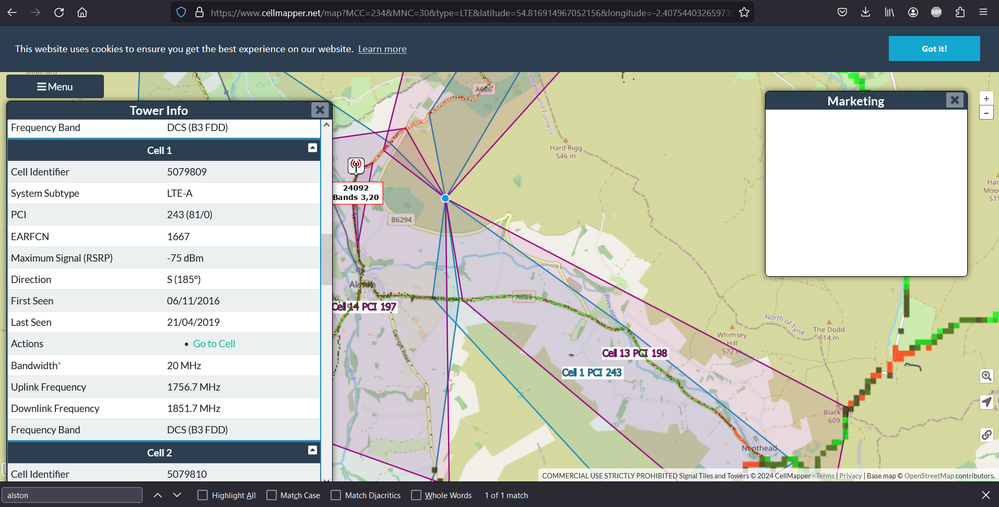

According to cell mapper I should be connected to cell 1 but I'm not too sure how reliable their data is. I can see the selected tower from the window where the modem is situated (and it has two external antennas).
I'm a bit confused as it says on Cell 1 that the EARFCN should be 1667 but my modem reports 1617 ?

I suspect the cell-1 data on CM may be outdated, the EARFCN 1667 is an older config and has been superceded by 1617. Your modem is reporting 2 available carriers - 20Mhz of B3-1800Mhz carrier on EARFCN-1617 aggregated (CA) with 5Mhz of co-located B20-800Mhz on EARFCN-6225

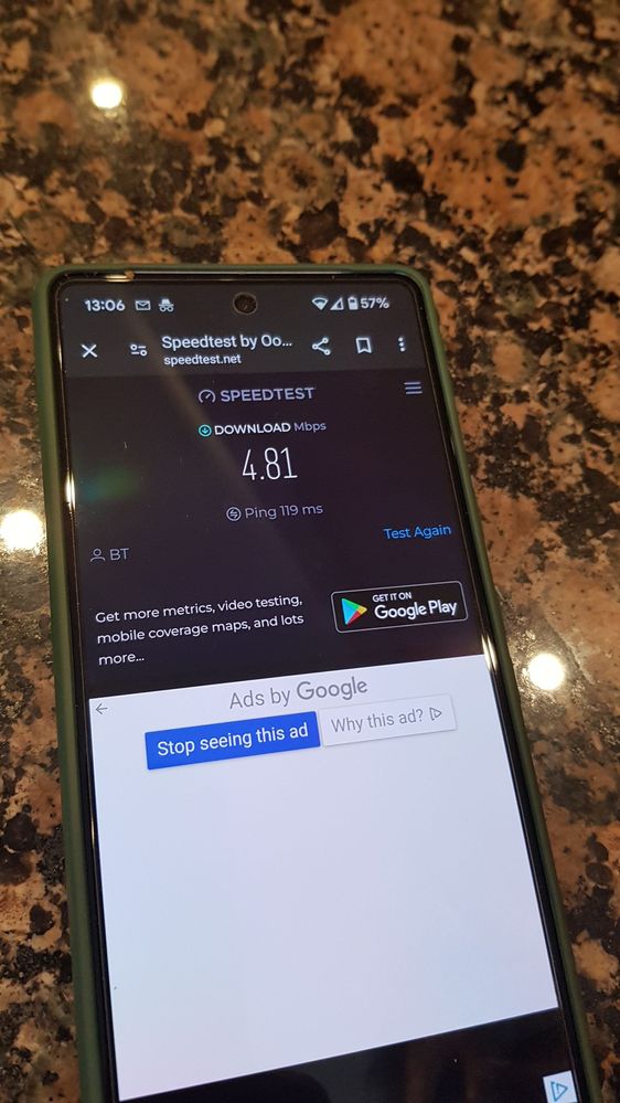

07-03-2024 02:13 PM - edited 07-03-2024 02:23 PM
I've just got back from one of my neighbours, who did a few tests on his equipment, bearing in mind that it's not usually that bad at this time of day, and it a lot worse in the evenings. He usually get's around 40-70MB download, also see his ping.
This is his phone, on his router / EE sim, on his EE account at his home which is around 1/4 mile away from me.
