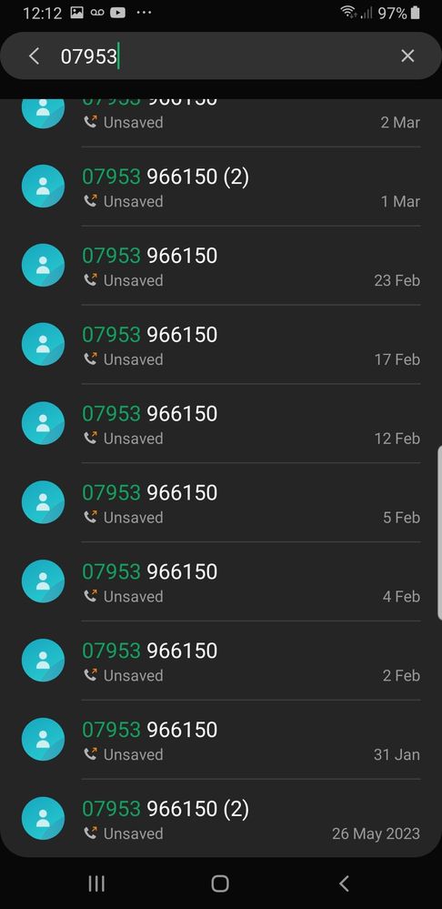

Since the 25th of January this year (which is also when work was done on our local mast) my pings have been horrendous. I've contacted EE numerous times. They changed my plan, sent me out a new sim card, etc etc but nothing has changed.
They did say they found something and changed the MHA and said the problem has now been fixed. Yet my problem remains unchanged. I have then called them quite a few time since only to be told they can't find a problem and it could be down to weather conditions or the infrastructure in the area.

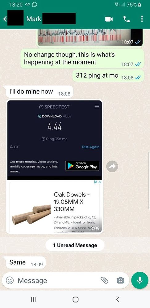

I have spoken to my two neighbours who live around 1/4 a mile from my location, who are also on EE 4G as we live in a rural area and there is no broadband or fibre available so the 4G internet is our only option. I asked them to do some ping tests and they also are experiencing the same issue, yet EE keep saying there's no problem.

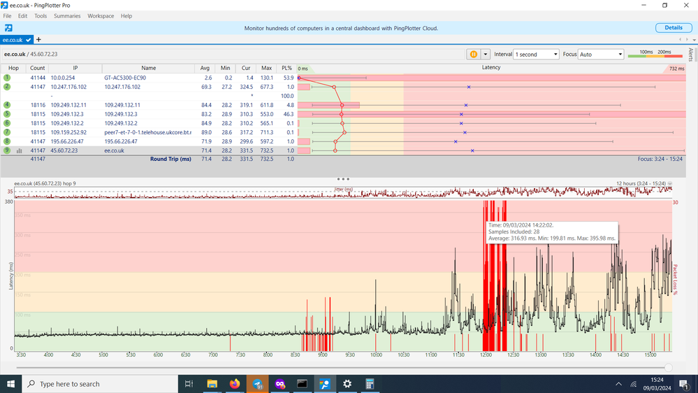

Everything works fine at 2AM in the morning! and the problems usually start to show around 6pm until 11pm on a weekday, and pretty much all day at the weekend. I've attached some pictures below of ping plotter, screenshots, etc.
laptop pingplotter 04/03/24
laptop pingplotter 05/03/24

Neighbours ping also on EE
Other neighbour Mark who lives 1/4 mile away

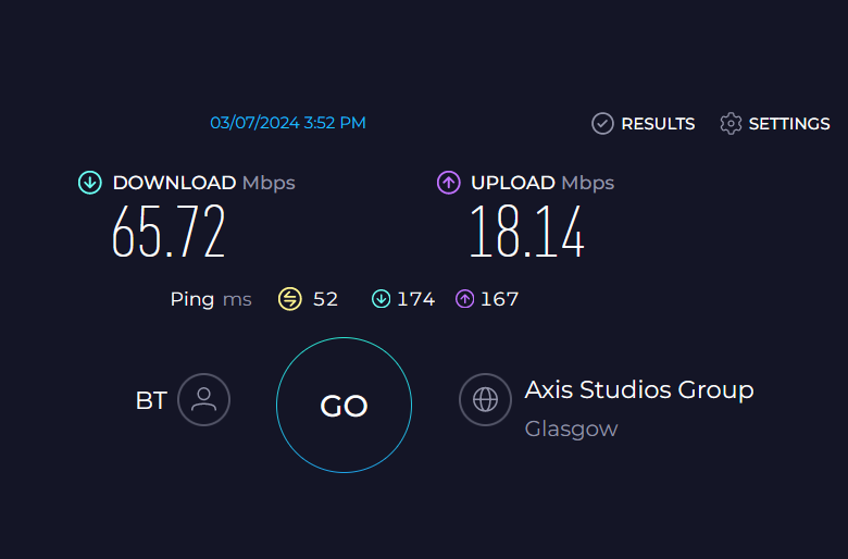

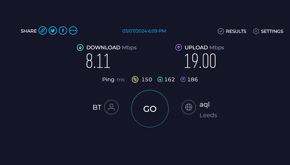

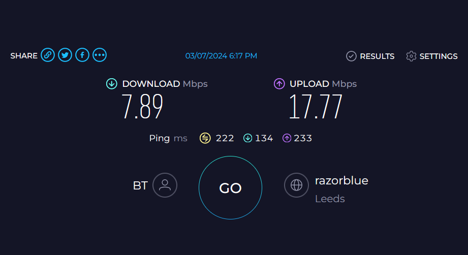

07-03-2024 06:25 PM

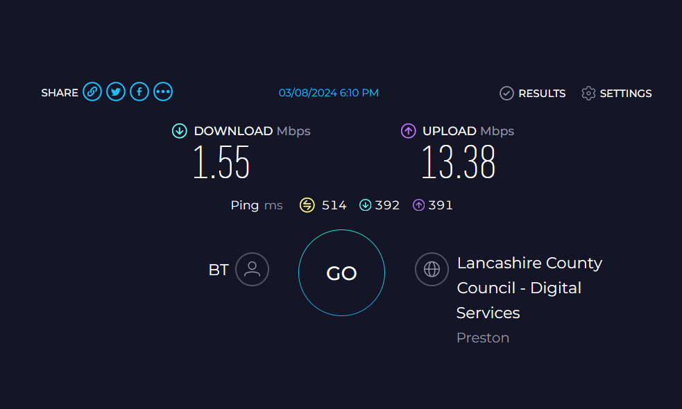

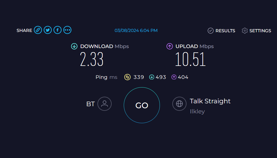

Speed test from Earlier today 3:52pm
Compared to later in the day...
I asked one of my Neighbours to test his speed too.
So he is also still having the same problem.

I did have a problem in May of 2023, which did get sorted, but alas no luck with this one yet as you can see from the number of calls since the 31st of January as I left it a few days after opening a ticket on th 27th Jan. I have also reported this multiple times on the coverage checker page.

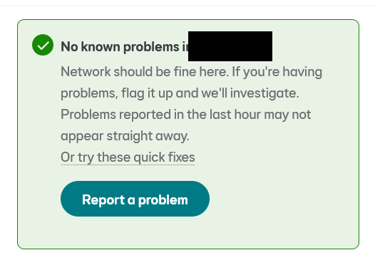

My phone is with another operator (Tesco mobile) which only provides 2G in the area, otherwise at this point I would be considering swapping providers to 02 if they supported 4G in the area.

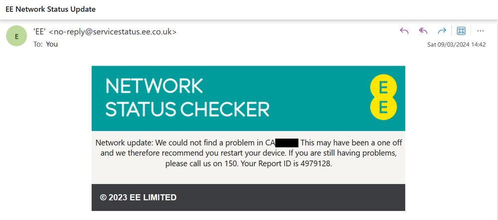

I just checked the status page on the EE and now they are saying that there is no problems in the area yet again despite yesterday it saying that they were investigating.
Yet my ping plotter from today it starting to show a different story...

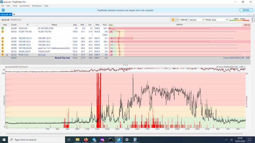

08-03-2024 06:50 PM - edited 08-03-2024 06:52 PM
Just got off the phone to EE yet again as the internet was pretty unusable.
Ping was over 1100ms!
Notice the MAX column
Speed test was abysmal (I did these while on the phone to customer services).

09-03-2024 08:04 PM
What's the issue you've been reporting via the status tool?
- Mark as unread
- Bookmark
- Subscribe
- Mute
- Subscribe (RSS)
- Permalink
- Print this post
- Report post
10-03-2024 02:56 AM
You selected: Data > Slow internet speed > More than once > Outside
There aren't too many options. Either "Slow internet speed" or "can't connect to the internet".
Then "tell us more" where I tried all different kinds of things like pasting ping's, speed test result numbers etc etc etc
I selected outside because I'm "not on a train" and the router is situated in the window facing the tower which is visible via LOS.
Same as usual..
And we had a maximum ping of 1825ms!
