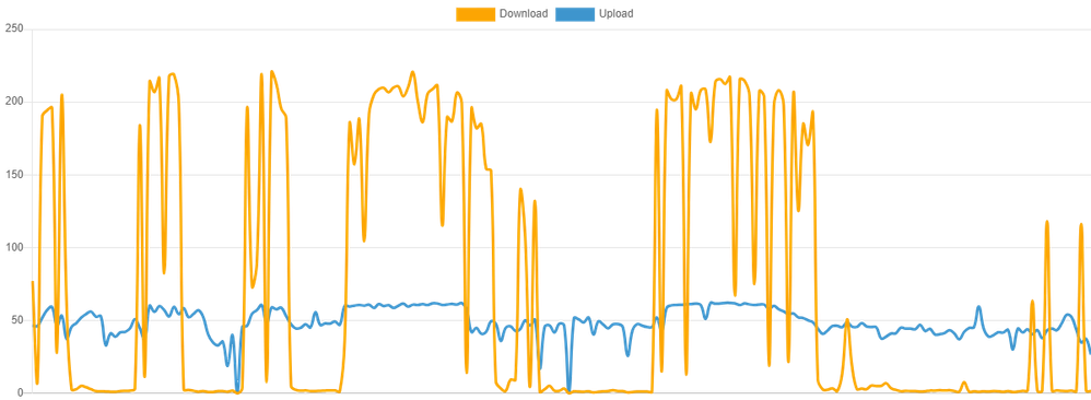

I've been doing regular speed tests with a docker image on my local network. Note, the x axis is misleading, originally I was testing every hour, and the container stopped at certain periods as I tried resolving the issue by playing around with DNS servers or VPN tunnelling. I switched to 15-min interval testing a couple of days ago (which starts about halfway through the graph). Total of ~116 tests.
TL;DR: The tests showing speeds of ~4mbps all start from 08:00, and stop at around 23:00.
Obviously, I expect fluctuation in data speeds, that's normal. But the consistent <5mbps speed for >12 hours a day is clearly more than a fluctuation.

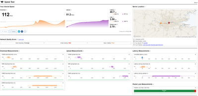

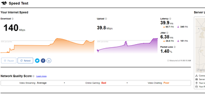

@AdamInt do your Huawei routers enable forcing IPv6 only? I'm only able to choose between IPv4 or IPv4/IPv6 - however on my phone I can choose.
IPv4 results (same location as router):
IPv6 results:
So, a short term fix might be to force IPv6 if possible. But I know IPv6 doesn't play friendly with a lot of devices (however it may explain the variation device to device, if some are being assigned an IPv6 address locally?)

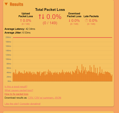

For reference, it's now 23:00 so my internet speeds are back to normal with IPv4 (0 packet loss too!):
Packetlosstest:

Thanks again for sharing. My results are the same, so zero packet loss when the speeds are back up.
