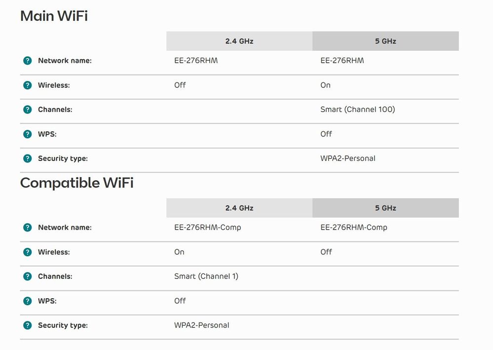

I have isolated devices, used compatibility wifi settings, changed WPA between 2/3, ensured I have latest NIC drivers and set them up appropriately.  I have ensured all my devices on the network have appropriate power management and network scanning frequency settings including disabling media calls to other devices being disabled.  I have also wired into the router directly with a CAT cable.  All the time I was doing this I was scanning my wifi and ethernet networks with Wireshark to get comprehensive details about any and all errors or discrepancies.  I have tried 3 different AI tools to check the logs and give me potential solutions and none of them have worked except to connect my PC with ethernet where the issue did not occur, proving it's the wifi on the router that is the issue.

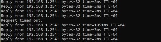

A typical lag spike will look like this (or with multiple request time outs and multiple ping lag spikes.  Also here is what Claude told me to tell the ISP when I contact them.

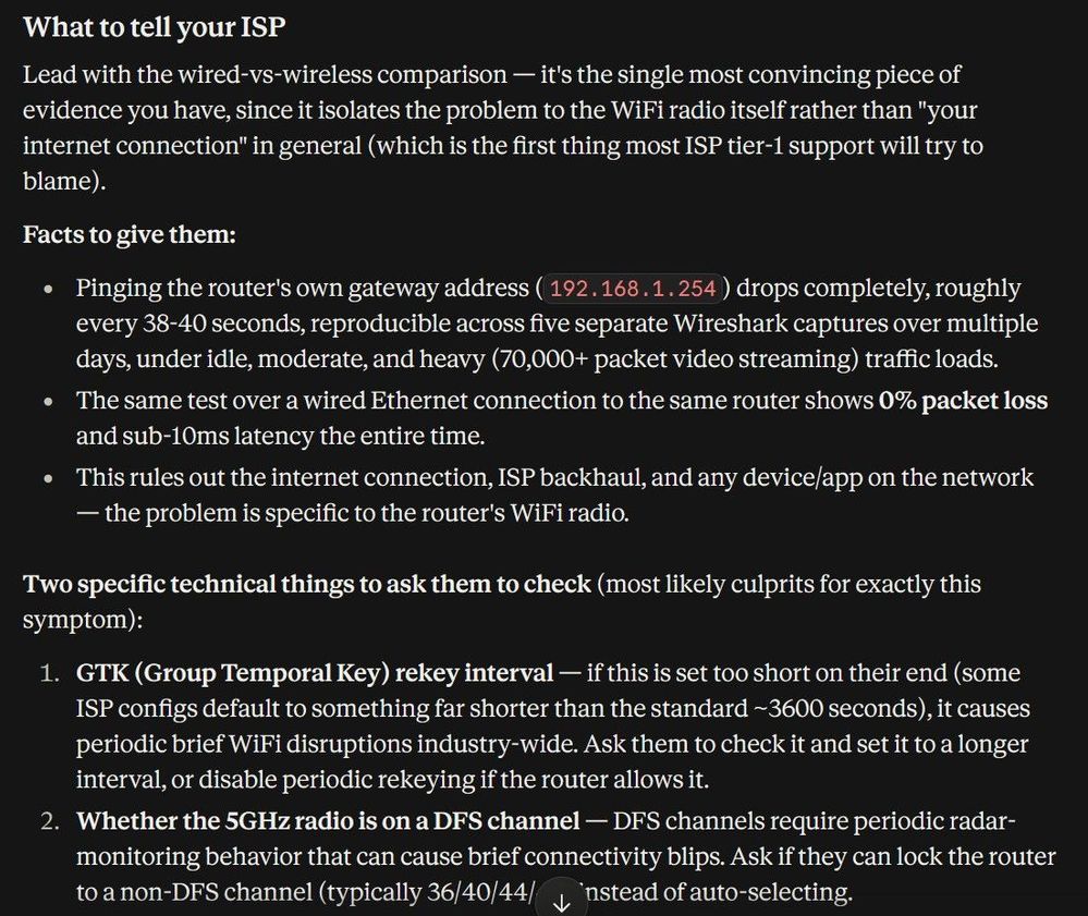

If needed I could post my wireshark logs, but they are awful to manually go through.  Instead I asked Claude to give me a summary as shown here :

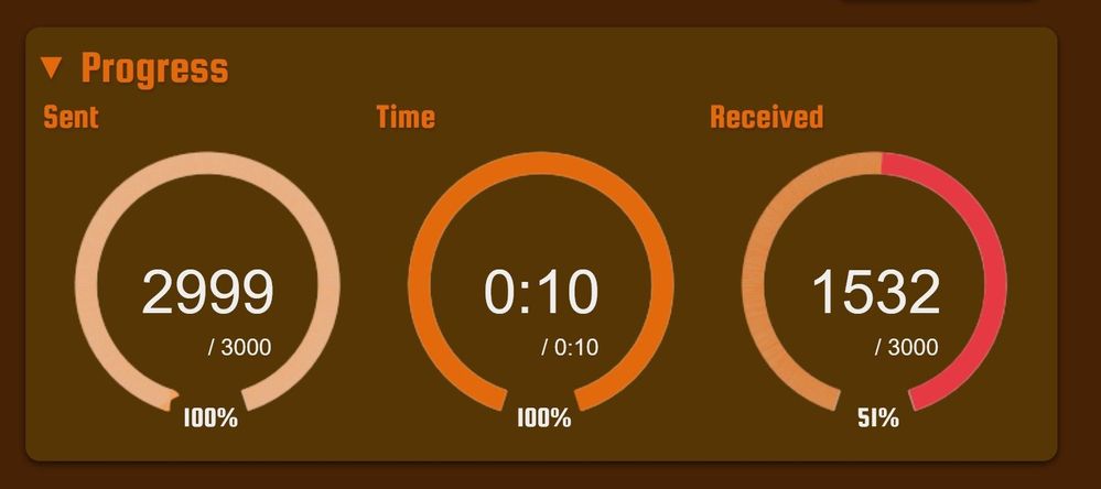

I had to run this a few times to catch the 38second lag spike as it was completing too fast.  Mostly it got 2999 back, but when the lag spike occurred it was 51%.

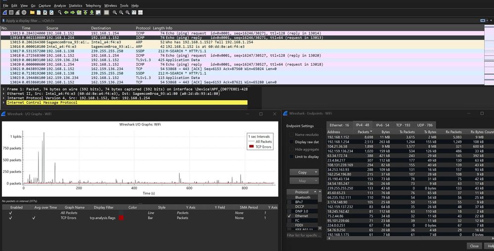

Here is a wireshark I/O graph and Endpoint chart for my last sniffing session.
Here is the results of the BBC ping session.
Hope that helps somewhat. Although I can assure you I've tested everything to the nines.

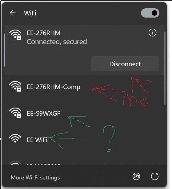

@f00n Have a look, is your hub transmitting the FREE for all EE WiFi ssid to be used?

Someone local is broadcasting it.  Not me though.

yeah I never had the guest account on at all.  I'm already paranoid about wifi being easy to hack without giving up free access to those without a flipper.
@f00n Ok will just have to assume you are not seeing it as EE switched it on to all there hubs on the sly you can see that from the FW pinned posting on the Forum, got nothing to do with Guest accounts at all. No body has posted any different so this is still believed to be the current and latest as off yet.
