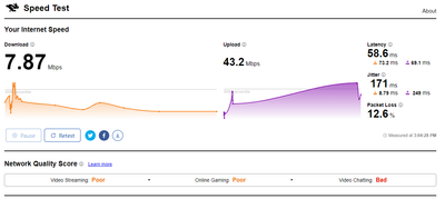

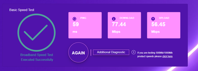

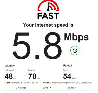

Just discovered something really weird. I thought it might be worth using different speed test providers (as I've been largely using just Ookla). I find google's to be fairly unreliable so tried fast, nperf and BT wholesale. Got some really odd results.
fast.com:

BT:
Weird eh? Having re-run the BT test a few times the download swings between 50-70mbps download.

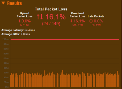

Sorry to spam notifications, was trying to maintain in one post but the time to edit has expired. Nperf's 15% packet loss seemed weirdly high, some further investigation via packetlosstest:
(This isn't a wired connection, but the 0% upload packet loss indicates the wireless connection is working fine)
