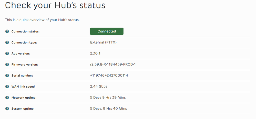

It seems to have something to do with Smart Hub Plus and a firmware issue. I had the same issue till I upgraded Hub on 17th Sep 2024 to Smart Hub Pro Yes it is £10 a month but touch wood I have had no issue with the DV so far and my Hub has been up for the last 5 days and this would be put where fault would start but after doing some google I have found that smart hub plus was rush through the door as they need a new hub for new EE mean why there a lot fault and problem with system but smart hub pro as been is works when I look in too new hub I found that pro as been in works for over year

@UkzVortex98 Good that you are on the new router and using DV also, keep the forum advised especially with regards to total uptime, any slowdown etc. Are you also using the smartwifi? Know you have posted some pics, do you have note yourself of current FW incase you get a forced change!
